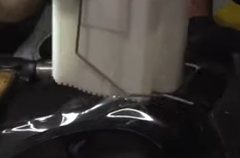

Just got done looking at several vids about how to do just that.
Why? Ever have a time when you needed to drain out fuel? O at least wonder why it can be running so rough?
You take out the lower back seat cushion and it will reveal a gasket that has wires running into it, that's the pump housing.
Pull it off...Look it over you might find a spare set of car keys from other people - possibly even road salts...mice, spare loose change you wondered where it went because it wasn't buried in the car seats...
Remove the electrical connector (pinch then pull).
Start the car a few times to pull out fuel from the line to help drain the line - pump doesn't have power now so it would be a good time to help it purge...using Injector and vacuum...
Might want to loosen - not remove the strap bolts to loosen the tank from the undercarriage - to give you room to loosen the locking ring.
Fuel connector - use a hook-pick to loosen the pinch points on that connector and bring towels to mop up.
A locking ring you turn counter clockwise to release from the tabs.
The ring turns - letting you lift, and push it aside - dropping the tank down - leaves room, so it slides away.
Gently pull - pry - and note location of tabs that seat the pump a specific way...
Pump lifts straight out - it's been immersed in fuel nearly all it;' life, so let it drain out back into the tank - the sender float usually goes to the bottom of it's stop.
  • so if it gets stuck look for where the float and it's arm are - it may have jammed against the opening - hence the tab/notch-seat orientation helps here...
Might want to inspect the tank and -if needed- siphon hose if you need to let the fuel drain and take some of it's debris out with it.
You can also see if there is any gelled fuel - shows up as blobs - sometimes of a darker different color - or since the tank is plastic and black - can often rest on the bottom as gooey rusty blobs - that's from the water in the fuel that got past the pumps own fuel filter. It can be sucked out - just can't use a motorized vacuum into a tank - but you can fabricate one using a bucket to hold the fuel before it arrives to the vacuum itself - like how they bleed brakes on a one man operation - you just have a bigger tank or bucket to do this.
The vid I found that does the best job of showing you how to do this is from the UK side - they're from those 1A Auto (Produced by TRQ) Auto clinic vids.
