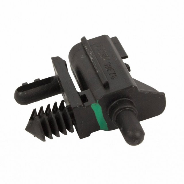

The only missing part I can notice is the outside temp sensor, because I have no temperature reading in the display
You should look into the owners manual for the vehicle settings. My 2011 didn't have a temperature display either when i got it from the dealership. If you go into the settings menus you should be able to select thermometer and also display in C or F.
Just made that part, but a friend told me of the reading is - -. - the sensor is either disabled or missing from the conector under the front bumper
It's part# DY-1160 , Motorcraft service part
