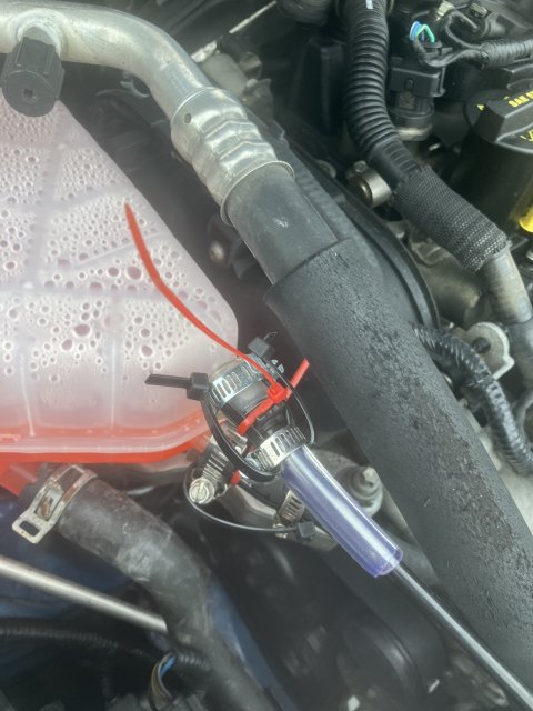

The 1.0 has some specific issues with its design that requires two separate thermostats, malfunctioning of either one of them being catastrophic for the engine is a major concern. All the other engines have a very “age sensitive “ coolant reservoir and plastic coolant lines. Just last week I found out that the coolant lines and their connectors had reached the limit of their lifespan. When I went to replace the coolant reservoir the connectors to each cooling line literally crumbled as I disconnected them with my bare hands!
The result being a cobbled up fix that took a while to complete so I could use my car until new lines come in. Failure of any of these components is a huge concern a blown engine kind of concern.
