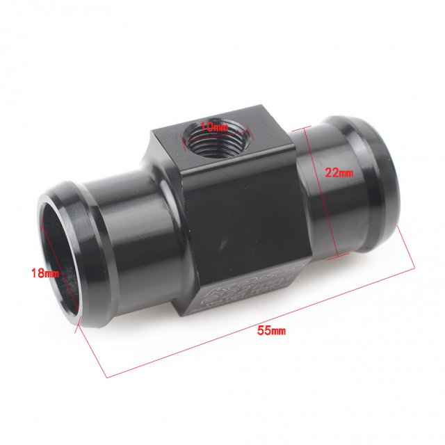

I would like to purchase an Auto Meter 2391 Gauge Kit for my 2017 Ford Fiesta SE Sedan.
The gauge kit has the following:
1. A Temperature Gauge which displays from 100 through 280 degrees Fahrenheit.
2. An Oil Pressure Gauge which displays from 0 through 100 PSI.
3. A Voltmeter which measures from 8 through 18 volts.
I will post a manufacturer’s web link.
What do you think?
https://www.autometer.com/1-1-2-3-gauge-console-oil-volt-water-elec.html
825
664
Sounds good. I wouldn't know what to hook it to, but there must be a way.
1,841
1,334
The "Auto Meter" types are recommended for only specific types of installs. The Coolant sensor for example - is for a type of bolt that when removed - has to be replaced with this unit. And is more of a specific size and depth. Particular for the engine block - not too many automakers set aside a bolt/plug for those who want this type of install - the choice is up to you - because as systems get more integrated the ability to get sensors in there are more and more limited
A Video can be seen here
Not too many cars these days offer an extra bolts/plugs hole or two for such an install - the emissions system itself already is going to take the best spots for itself by the manufacturer design.
So, unless Auto Gauge can get on the phone and guide you to the spots on the vehicles engine so these can be installed as "stand alone" and not piggybacked and affecting the emission side of the detection, reference and pressure - this may be a waste of time.
People whom show you a water gauge temp sensor - on the hose - remember it is requiring a cut into that line - and will only get the temperature for that section of hose and if it's run thru a thermostat outlet, the thing will be slow response when cold on a regular basis the suddenly rise up then drop back off when the thermostat shuts - so if that's what you want to see - expect the problems with leaks in the hose for the hose it's using will be compromised by the "adapter".
Same thing applies to the Oil Pressure, the best method is to use a TEE fitting and allows the sensor to tap off of one side of transducer that already there.
The worst part of this is the electrical system inside each gauge is only regulated by the power supply feeder line - so if you have it direct to the Fuse block - you get one result, tap into the battery, you get another (and no way to turn it off) If you use the Voltmeter - the thing can be hooked up for you to monitor battery status all the time - even before you start the car. But the other gauges will need a separate feeder - which is why I bring up that point, for they will be sensitive to the abrupt changes in the power supply voltage as devices; like A/C - Blower and Audio engage the regulation and charging system in their own way - so you may see fluctuations - which is normal - but might mis-lead you to think something else is happening.
Seriously, for if you can show where you can put these on the BLOCK - and put them in a video to help - you might get several hundred (thousand) hits just for the learning process.
1,901
1,612
I have used an adaptor that has a threaded port machined into it for a water temperature sensor. They come in various diameter and are placed nearest to the coolant outlet of the engine cylinder head. They are generally made of aluminum and are not expensive. From less than $10 dollars to around $20 dollars, depending on the size of the adaptor. The closer to the water outlet the better. I have to add that i think this would be better in terms of providing information about engine temperature than the factory temperature sensor outputs from the factory setup. The factory temperature sensor outputs are so heavily buffered at the ECM to be almost useless as an "early warning" solution. When I was autocrossing my 2011 Fiesta, i rigged up a J type thermocouple near the coolant outlet of the cylinder head and was shocked by how quickly the the engine temps would spike during a run. The thermocouple told me that the engine temps were much higher than what the factory temperature gauge indicated! The situation was concerning enough to motivate me to create a ducted and vented hood. hfhhlminfjhiqehpfjqqmjlllmkpmmjkjhhgAGxU.jpg 20220202_181151_(1).jpg
