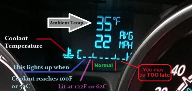

Here is another friendly question for all Ford Fiesta Forum Enthusiasts:
When I look at my “digital engine temperature gage” on my dashboard,
it just displays as C all the way on the left for Cold, and H the way
on the right for Hot. I am guessing that the lowest cold temperature
is 180 degrees F, while the highest hot temperature is 220 degrees F.
What are your thoughts?

I get 4 bars once the water is up to about 100 degrees. It's never gotten above 200, and I've never seen more than 4 bars, ever. I stopped monitoring water temps because it's so stable.

If and when it may ever occur the TOO Late part, the cars' engine gets a little funky - runs extremely rough and will try to cool using two cylinders alternating to fire, with the other two pumping air just to pull air into the cylinder no fuel - to take away heat.
It's in your owners manual - and usually by then, the overheat condition has already caused severe damage - this mode of operation is so you can get out of whatever you're in to escape - but the engine is suffering from massive overheat condition.
The TOO Late section takes a LOONG time to get the bar graph up that high, and it's usually from something going (boiling) dry to make it get there.

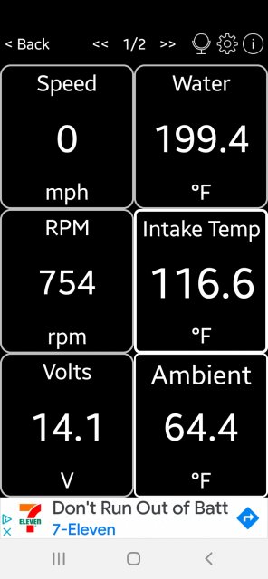

OK did a little test OBD2 with Car Scanner for Android on my way to Cars & Coffee. Coolant bars came on at 85F, 95F, 105F, & 120F. Car saw 199.9 with 77F ambient crawling in traffic; did not light the 5th bar. My ambient off the OBD2 is not correct. Not sure where it is pulling that from. My dash displayed 77F, which matched my phone; so not sure what that's about. Seriously considering a self-made custom intake mod to lower the intake temp. It ran 25-35F hotter than outside temp. Love having Volts and Water as real-time data not just an impending-doom/you're-already-screwed light.

I'm finding Ambient "sensor" - just under the hood at the Air intake snorkel side, just in front of snorkel - behind Grille - towards top - has a little cutout you can see from where the snorkel mates with it's formed cutout on the main radiator cross member...
They are not the ones located on the cross bar member at the grille thru which you can see, the one I speak of - is on the top of the grille opening - i set a code and light on the dash when I tried to work on the snorkels airflow thru that cutout. Forgot to reconnect it one time - shows "0" and --- if left off the connector.
