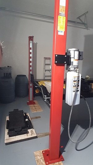

I synched up all the fasteners, installed the safety lock release mechanism and mounted and filled the hydraulic power unit. All I need now is electrical and to make final adjustments. One of the counter guys at my local NAPA was an ALI certified lift installer and offered to swing by and help me adjust everything up right. Gotta get the bridge jack placed between the runways too.

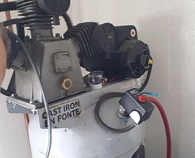

Today I concentrated on assembling the air compressor. I have pieced together some components to upgrade from my old 35 gal horizontal to a 60 gal upright. This will move me from 9cfm to 18 cfm and from 125 psi to 150. Im adding cooling pipes between the compressor and tank to dry the air as well.
I havent decided how Im supplying the garage air, plastic or hard pipe. As for right now I will connect after my AquaChek filter and regulator mounted at the wall beside the compressor.
Electrical will be completed to the compressor and hoist Wednesday next week. Ill be able to finish up the hoist adjustments and put it into active duty.

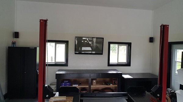

I also took time to mount my TV and 4 speakers, however nothing is wired up yet. Today it was just a 50" USB audio player. I am going to purchase a rack amp with USB and bluetooth connectivity.

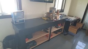

Now I have to get back to building benches and cupboards so I can finish moving all my junk in!

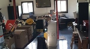

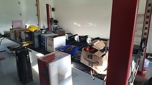

Another move in day! However this event was in response to my wife's desire to get a start on my son's bedroom redo. I need to empty the 10x16 shed that has housed all my tools for the last year. Now I need a space to move my son's furniture and belongings to.
While I was moving and emptying boxes I decided to sort some tools. I have way too many drill bits. I like my black oxide low speed bits, I threw away a whole set of Titanium HSS, never liked them. Plus I made a pile of crap I need to sort. Its amazing what one collects in time. Extension cords out the wahzoo, tie wraps galore.
Found a bunch of stuff I was looking for too. 30W compressor oil...after I bought some. Pressure switch for the compressor...after I bought a new one! NIB Oxy/Ace gauges.
If anything, so far Im glad I bought the hoist. It makes a great bench to pile boxes on.

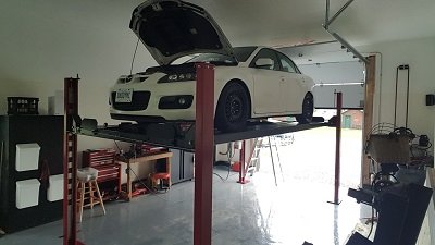

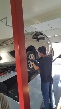

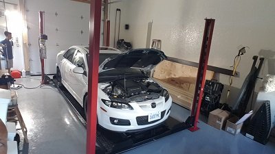

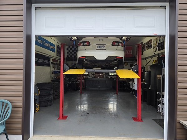

After some measurements & adjustments and some lifts, then more measurements & adjustments and some lifts...
It lifts! The action up or down is smooth and I am very happy.
And the first job I chose to complete was sway bar links on the FBomb with the help of my son. He is totally pumped about the hoist too!

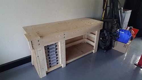

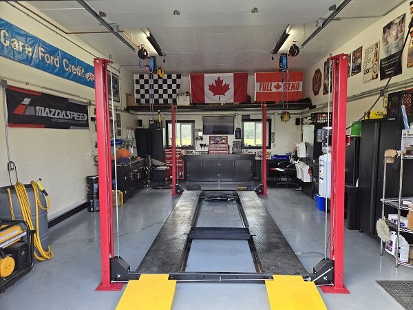

Built another bench. This one is 6' long and will be used for the bulk of my heavy work. It has been extensively braced both inside and out. The top has a pad for my vise and the cupboard bottom has extra crossers for large/heavy items. The storage kits clears up a lot of mix matched containers for small components. Light bulbs, fuses, heat shrink, terminal ends, hose clamps etc.
SyntheticAtmosphere
217
187
Not-US
Thread Starter #47

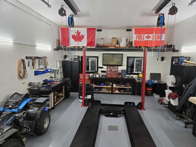

Its been a busy summer around here. Ive been redirected to other work around the farm and working on the GarageMahal has been sporadic. But I do occasionally get away and have been able to keep the ball rolling. I even had to farm out the rear hub replacement on my wifes CX-5. I just didnt have time.

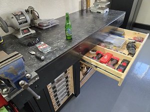

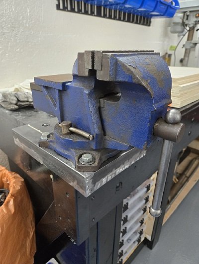

I have completed all my workbenches and setup the work areas. The benches have been painted, filled and tool mounted. I still have to paint and mount the doors and I plan to build a drawer on the heavy bench. I welded up a metal bracket to brace the vise. I took a few good whacks at it to test it out and it does not move...mission accomplished.
I completed the storage mezzanine and loaded it up with my junk. Now I can set up the 16x10 shed into a woodwork space keeping pesky sawdust out of my garage. I also scored a great sale on 2 50' 1/2" retractable hose reels at Princess Auto(Canadian Harbor Freight). Plus I also snagged 2 electrical retractors during Prime days. The beer fridge is in, all the trim is painted and the lighting is all mounted. Soon my electrician friend will swing by and we will punch up the conduit and wiring for the lighting. I have 4 ceiling mounted lights that provide indirect light pointed on the walls to light up my memorabilia and decor...Great for when drinking beer and watching TV. At the 8' level I have 3 6000K LED strips on each side for when Im working on cars (these are on in the following pic). These can be a bit much if you arent needing to see detail. Plus there are 2 more above the front wall bench for engine work, but again to watch the TV they will be switched off.
Over the winter I dont have much else planned. Come next year I hope to set up the off grid solar collector heating as I am currently relying on 5000W of electric when required. I also will be digging a well/cistern and getting outfitted with running water.
By now Im due to keep the wife happy and will be busy redoing my daughters room (carpet to maple hardwood floors and removing popcorn ceiling) and putting new counters and sink in the kitchen. Atleast I have a space for me time now ;)
