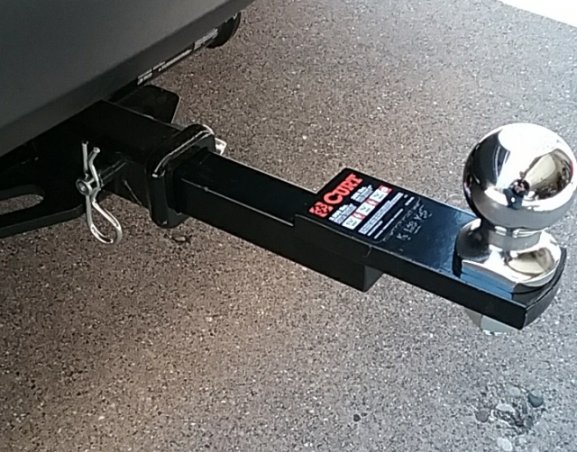

I myself installed a hitch for making my 2018 Fiesta SE more of a workhorse. But when it comes to suspension- I actually went UP in height for the needs of the roads here in Southern Michigan and Northern Il tend to be more along the lines of a mountain trail excursion hike than a simple trip to grandmas house.

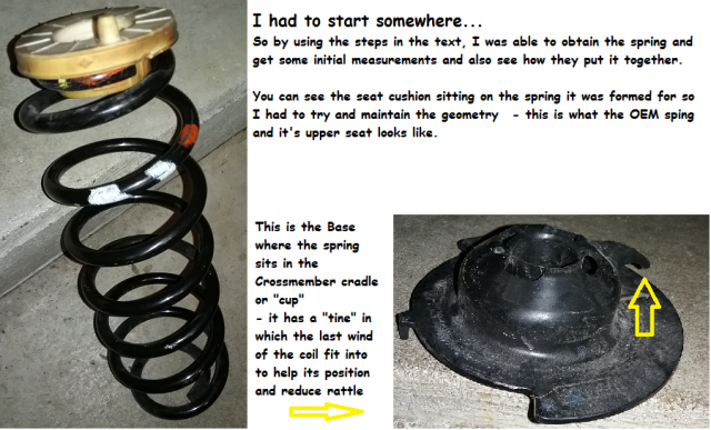

My concenrs - as said before, were from road conditions and for utiliy I will need the car for. So I took apart the rear suspension by unbolting the rear shock botls and simply jacking the car up so I caould locate the "tags" for the springs and even let them drop out so I could measure them for what my new height requirements as well as spring "style" was.

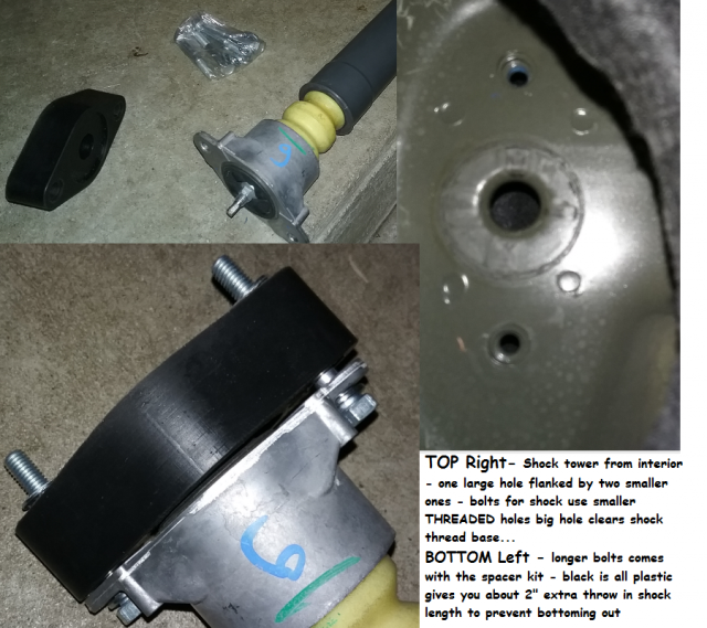

You will need to extend the Shock Absorbers too, for they will "bottom out" if you're on rough roads...So you'll need a spacer - found this on Amazon...

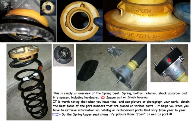

As far as the Springs go, the OEM ones are quite short and as you lift the rear up - you'll see how they are placed and seat. They are considerably shorter than what I was surprised to see and did not need to use any type of coil spring compressor to remove them. It (steps to do this) was to loosen wheel nuts, Remove Rear Shock Absorber bolt from the Crossmember - Wheel chock the front tires - lift rear cross member - remove wheels - take a SECOND jack and lift entire rear to allow cross member jack down - springs fall out - that simple - didn't have to be concerned with the brake lines - they will still be curved enough with hose line length to allow the hubs to rest smack on the pavement. The spring base in the crossmember pretty much handed the spring right to you.
New springs were stiffer as well as longer so the ride height is better for rougher terrain and roads that would have taken an ST for a wet piece of paper and pretty much shredded the undercarriage.
I used per website above - Monroe 81055 - below is what you have in the OEM Ford you have now...
They've been replaced by the 81055's - note the taper winds and the "banding" - it identifies that is their top - the bottom side that seats in the crossmember housing is on the bottom - the box the 81055's came in is what Iv'e stored these in case I need to revert back - if ever - not likely but - then you never know...

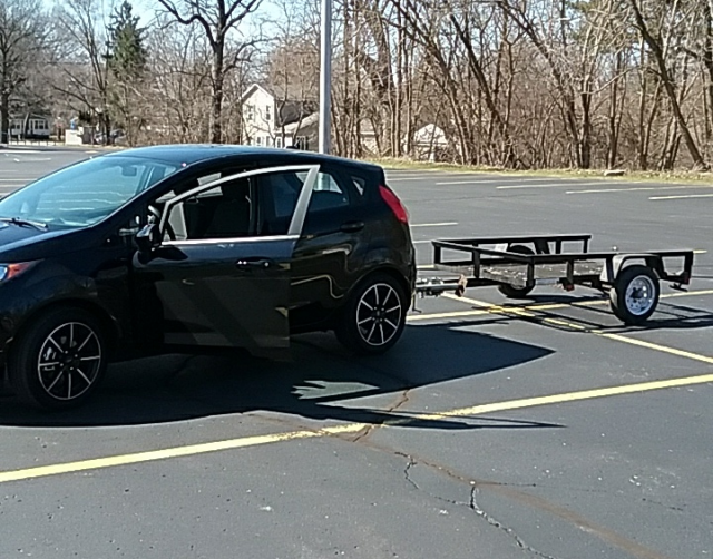

This isn't everyone's' cup of tea....
The above is after a years worth of use - so I apologize for the mud, but it's my mud, not yours...
