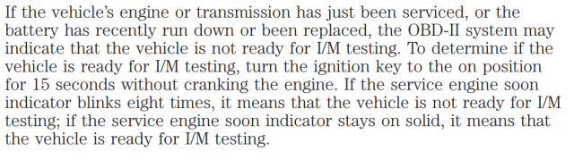

To me, this is why it's important to keep an eye on your cars battery.
It can affect Fuel mileage due to a "reset" that may occur during a power down sequence that was not completed because the BATTERY Monitor function engaged while it was still powering down. The Voltage from the battery dropped faster than the system was expecting - so it simply went down due to the rapid drop - and the I/M monitors or any sort of emissions testing - never completes the cycle.

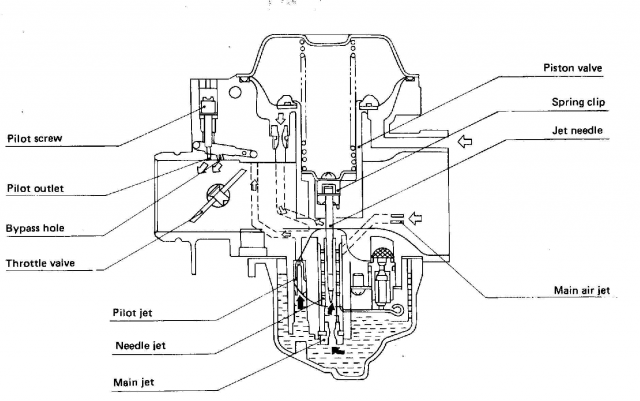

IN the older carbureted systems, they used a predetermined size of orifice - called a "jet" and small tapered rods called a Needle slid up and down within the orifice of that jet - with the throttle angle, (Often, this is referred to as Needle and Seat)to change the amount of fuel brought into the air mixture thru the Venturi principle - which was helped along by another sub-system called Accelerator Pump - a small piston moved in sync-with and with an eccentric, to help move more fuel into the airflow to improve the power delivery that depended on the throttle angle - but by only so much - to help with acceleration and the vacuum drop from engine load changes.
So to develop proper efficiency the system needs air to move the injector spray into the combustion chamber - so it needs air to carry it in to move the charge to make the system work - a minimum RPM is needed to pull this into the combustion chamber - that is your lowest RPM to prevent lugging.
