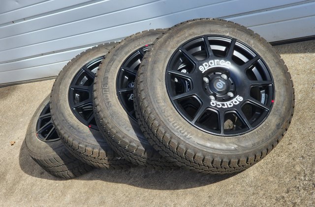

Currently running Control Advantage from BF Goodrich. Wear like rocks - so far, so good.
Steel rims 15X6 with +47.5mm Offset X 4X108 185/60R15 - seems to provide a good "on-center" balance no issues with high-crown or rutted-pavement roads - seems to hold their own.
Later in January though, the forecast calls for more snow and ice - will keep you posted.

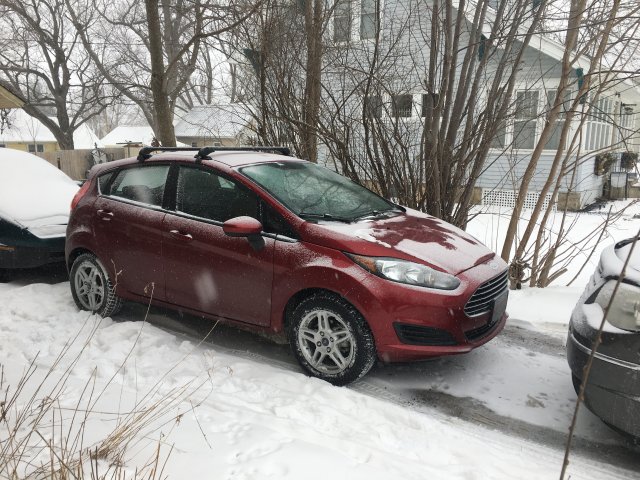

I'm in MN and I have Bridgestone Blizzaks I've run for 2 years. They've been awesome.
Have you noticed if the traction controls are very sensitive if left on in slippery or heavy snow conditions on your fiesta? My 2011 has always been a reluctant player in slippery situations because the t\c is very active. I had General Altimax arctic tires and they were pretty good. All season tires were worthless in winter use.
It is pretty invasive lol. Not the worst I've seen but it definitely intrudes a lot.
