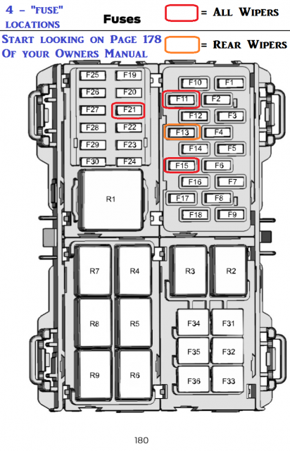

I've checked the fuses (different fuse box on my car) and none of them are showing signs of problems. I've taken out the three fuses related to the wipers and also swapped them. No luck what so ever :(

So since the clamshell costs more than the vehicles worth, I just settled for trying to remove which fuse the rear wiper used - by process of elimination is where I found the ones circled. The Owners manual helps but only so far.
On the left "panel group" the only RED circle was the INPUT fuse power - which when pulled, took out "killed power to" the entire wiper system, the three on the right side panel group are the BCM's outputs - fused to protect the BCM. With "amber" working the WASHER for both Front and Back.
So on your vehicle - since it's a 2009 - documentation is limited on-line to find and source it - for I was showing you my owners manuals references and since I have had similar issues - I'm trying to offer help.
