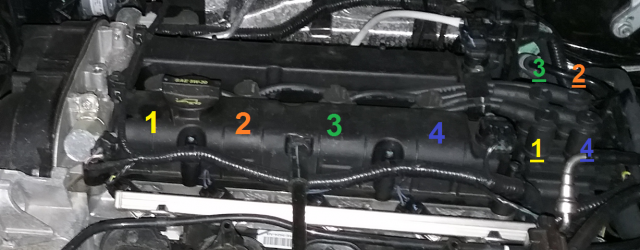

You said you changed the plugs, recheck your plugs and wires, make sure the plugs are tight to the seat (don't overtighten, just backout and reseat them) them to make sure they didn't jump out - then also re-check your boots.
To help, on my car (2018 Fiesta) - the firing order is 1 - 3 - 2 - 4 - so remember this when you work on these - that you don't pull all the wires completely off the engine unless you know and or at least took a picture of what the motor looked like before you did this.
But locating Pin 1 to Plug 1....
The jumping of the airbox is a clue that it may not have jumped time, but it is thinking of backfiring. This means a timing or plug firing issue - make sure you have the wires to the right plugs - and that all the plug wires are checked good, you use an ohmmeter to do this - one lead to one end, other lead to other end and set for 2K resistance - should show ohmic reading - and any open ones got broke when they got pulled or otherwise twisted. They're pretty durable, but not unbreakable.
IF you think you have it right - and still have this condition - the plugs might be bad, as in a fouled out or cracked plug - making a vacuum leak into the cylinder it's mounted to.

Econoboxrocks - after reading your post, I checked the wiring with no issues. I also had another look at the spark plugs. I retightened them, possibly over tightening them a little but it didn't make a difference. (annoyingly the only torque wrench I have capable of measuring 15Nm is a 1/4" drive, and my spark plug socket is 1/2" drive). I also put the original spark plugs back in and it made no difference.

I've now checked the ht lead impedance and order and all is fine. The battery voltage is comfortably above 14v when running and I've drained off ~1/2 litre of oil so the oil mark is half way between top and bottom on the dipstick (when parked on a flat road).
