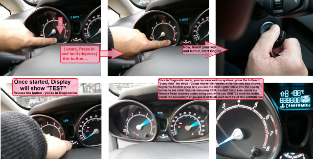

Put the thing in "test mode" by (if they'll let you)
This is a transparent way to see how the former owner took care of the vehicle or not, this diagnostic mode can help you in making a final decision in both how well the gauges track the Displayed data (analog vs Digital realm) as well as various other features...
I'll share more in the next post to help you...
