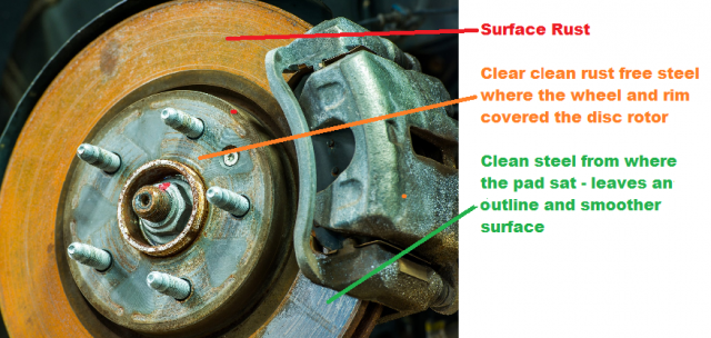

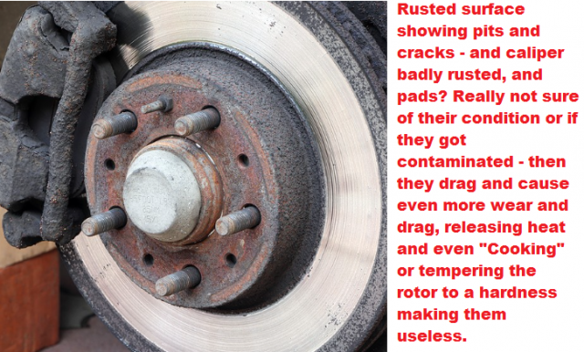

Lots of times that "tick-tick-tick" as you slow down, is from the discs, the rust to clean to rust - the tick is the slop or shift of the pad from tight clearance (squeeze) to the more open and less frictional "clear patch" of where the pad rested on the disc when it sat for a while - no water or moisture got between the pads and the disc, but the open air and water rain snow and moisture from fog - gets and attacks the iron in the disc in open air forming rust.
May be temporary, but if the vehicle sat or got parked in a deep puddle - the iron/steel of the rotors will rust and generate a "bulge" and rough surface until the vehicle can be driven and that surface can get honed down. Driving it a lot of highway miles can let the pads hone and resurface the discs - but that takes a LOT of miles on a badly rusted disc or even brake drums - they too suffer similar fates - so you'll have to look at your brakes with the wheels off to find marks from the long sit of rust to no rust areas where the pads kept the disc from getting exposed to get the same level of exposure and rust from the elements the rest of the drum or disc got from nature.

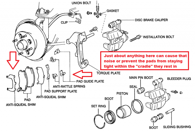

There are many reasons for this "knock" - even out of round condition and as you have noticed, even the fitment of the replacement pads can make it loose in the cradle - the clips are supposed to remove most of this but is not a cure all...
This is a representative - for parts list locations, identification and placement; see service manual, usage and data rates may apply, use only as directed.
