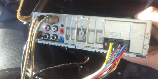

So ive had been having a issue with the speakers popping. And then radio goes out. Restart car radio works then after while same thing. Soooo being the guy I am Im popping door panels and checking speakers. Ruled those out so I keep digging ans pop center console out and radio was blazing hot. I think im in for a new head unit. I did just have my battery checked it tested bad. Got a new one and I'll put radio back to see if that was a cause.....never had issue with headlights or starting car. I did have a line out converter installed but removed and also never solved issue.

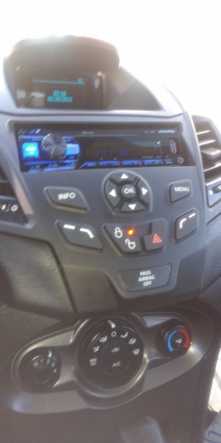

I'll go with a new head unit anyways. Id rather not have a line out converter. With head unit the little screen on top I think wont work. Which has date. Time. Ect. But that is also true that traction control is controled with that screen.

Wait that's not true.. My mistake. That will still remain and work. Theres a circet board on the back side of the trim plate that has the power button and lock and hazards. The fit kit has to have the oem board from the old one installed on the new..new radio will also fit in the new fit kit.

That works!
