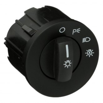

I have an SE fiesta and i got some fog lights for it and installed them easily since there was already wiring for it in the car but my light switch doesn't have a pull to turn on fog lights. how can i get one of these switches because i cant really find them online and auto parts store says they're all out of stock
i have this
but i need something like this
You are going to need the headlamp switch for the fog lamp (from the dealership parts department)as well as paying the dealership service department to dive into the “as built” menu and activate the circuit.

Ford Part is
D2BZ-11654-A
Motorcraft Cross references is SW7024
If there is any in stock.

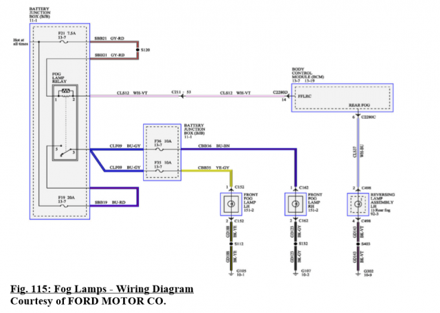

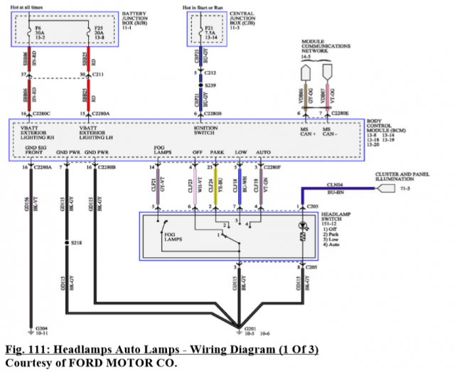

The Body Control Module powers the relay, by acting as the ground point for the coil of the relay.
IN the upper Graphic - the Fog light selection thru the switch - it grounded at the switch - which then leads back to the BCM - which in the bottom graphic, has a separate connection to the FOG Light relay. Which when the ignition is on, the Fog lights come on - and the system shuts it down once the ignition is off and the key is removed. So you know - that BCM controls many of the electrical (if not all) to save the vehicles battery.
So if you buy the switch and can't seem to get the Fog lights to work - make sure you have fuses for it installed, and it's relay, and if necessary, you can then install the fog lights but mount a switch to GROUND instead of the Body Control Module doing it for you.
This is where the "issue of the Dealerships" comes in. IF the BCM can work the fog lights because it's wired to the fuseblock, then installing it's relay is simple enough for anyone to do and the switch knob can be replaced too. To have the dealership do it, requires a considerable amount of interior work disassembly and reassembly and the actual verify and install of the wiring to the BCM from the Light switch and the inspection and rework of the BCM itself - to make that Fog light switch wire contact - GROUND at the BCM.
IF not, then the main problem you may have is that cost of them doing it, or the inconveniences of you having to do it yourself.
