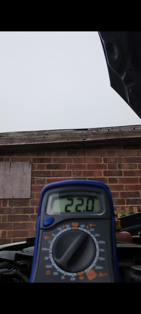

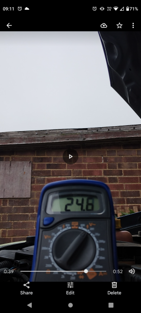

I did a quick test for voltage at the relays this morning before I had to go out and the readings don't seem right to me. Testing on Relay R2 terminals 1 & 3 should read about 12v if I'm thinking rightly. I'm getting more in the range of 20V for each terminal. This doesn't seem right to me.
22.0 for terminal 1
24.8 for terminal 3.

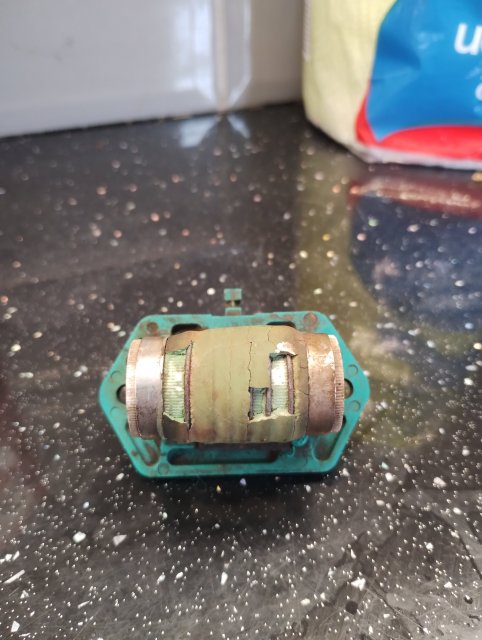

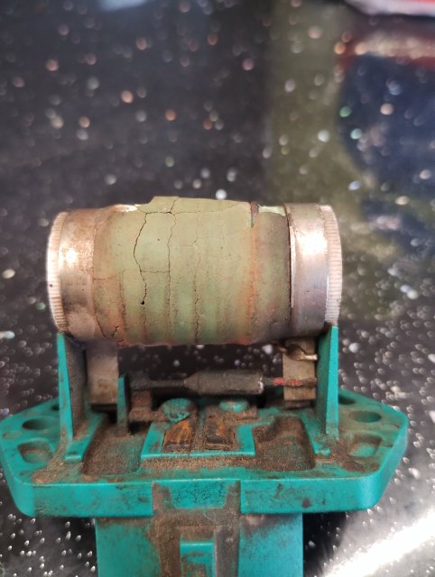

I have also attached pictures of the resistor.

I'm a sausage. I had the Multimeter on the wrong setting which is why it was giving me them strange readings. I can confirm the relay box is receiving 12v and there is no break in the wire between the battery and the fan itself.

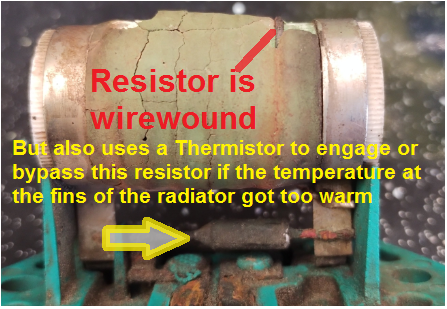

Then the coolant sensor is faulty- but with all the messing around (alerts) going on, I'm thinking - some lean to, corroded wiring issues so be aware of that as you progress. The resistor is toast - the case is showing some cracks - even if it's mud, when the wiring in it - being plated - is rusted like this, time to change this out.
The socket plug that the Resistor and the Coolant Temp sensor goes into - might need some TLC so see if you can work in some means to clean it.

This is for the reader that comes across a similar issue - as a Legacy post,
Wanted to help others in finding theirs...

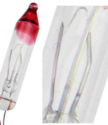

To me this may be more of a limit switch - kind of like those you'd find in a Xmas-tree string of lights. The one bulb lights up the whole string - but if its bi-metallic arm touching the filament making the circuit complete - warms and gets hot, it lifts off the filament and interrupts the power flow for that string.
Since it bi-metallic - it can cycle the lights on and off for quite a while as long as the string is not subjected to abuse.
These limit switches work in a opposite way, its OPEN when cool or cold, but when the system needs or demands more cooling - this limit switch then "clicks on" and bypasses the resistor - it acts like a dead short taking in all the current thru it to allow the fan circuit to be complete and run at full maximum speed.
These are not lifelong units in high current loads - they can only do so many cycles of this - then they are blown open like a fuse and won't work anymore.
