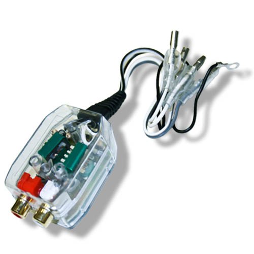

You can use a Speaker RCA Line Level Converter to send signals to your amp.
lessard.dcj
Thread Starter #17
the idea with the line converter is good. but don't use a crappy convertor like the one you posted MK, look online for an active output converter with an amp signal wire. like this
