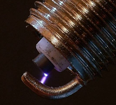

Some plugs claim to offer less firing voltage requirement - which I find quite a confusing effort to sell a plug on the basis that the arc itself needs to ignite the fuel air charge, so to say "less voltage" might be a misnomer, for it may be "less current" that is needed to pass thru in the arc due to the construction of the plug and Iridium's inherited intrinsic traits of conductivity and hardness - which will make for a heat transfer condition that makes the electrode hotter, changing the way the arc can form and jump the gap to fire the charge.

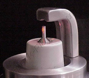

In this example, the ARC forms where the closest point
between the two electrodes exists.
See how far the outer arm of the ground electrode sticks out,
yet it is not used for the jump or occurring close to where the charge resides
- so much of the electrode surface that can be used for the arc
- just sits there gathering carbon soot from the ignition and burn.​
  • Perhaps it can be better explained in making the electrode design different - by making the electrode more of a pinpoint firing location - being that the direction of arc and where the arc can reliably form from - the construction of the electrodes and their design make more of a difference in ignition and how the heat formed during that arc discharge can be kept for the next firing sequence.

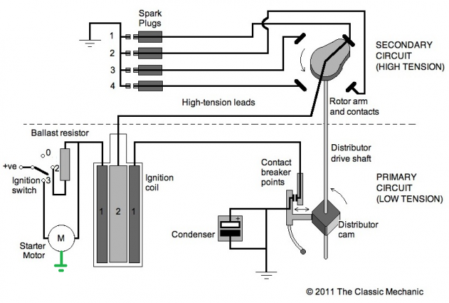

  • There used to be an older ignition system that used a rotor cam off the distributor to operate Points and Condensor unit using a set of contacts that to reduce pitting and improve their life, they used a Ballast Resistor designed to reduce the current that the contacts sent to the coil - when the engine was running.
    • When you started the engine, that resistor was bypassed by the Starter solenoid sending power from it's relay straight to the point and condensor - so the system saw full voltage and made the plug arc from the extra boost in current - even at a lower voltage.

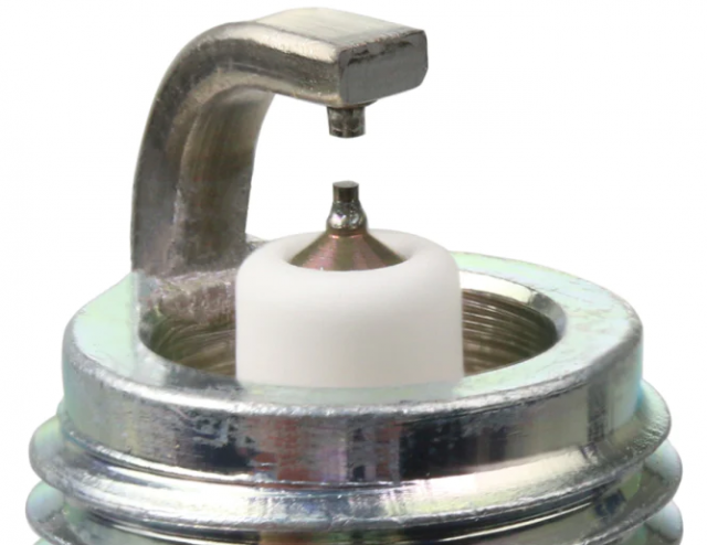

Back to Iridium - high tensile (brittle) high meting point also has the best corrosion resistance to deposits as well as best material deformation characteristics - so since it has a very high melting point - it can stay hot and shrug off carbon deposits that other cooler plugs would foul and lose arc due to the carbon trail losses in the gap making conductive paths so the arc can't form - it's found a route around the gap to ground - thru the deposit is an easier path to follow.
You need a high voltage to for make the arc even occur (breakdown potential needed in the atmosphere and pressure in the cylinder during compression) once that is completed - the current - or amount of power passed in the arc jump - is limited by other factors - including the plugs own internal suppression resistor and the ignitions' pulse duration and field density of the coil and it's winds - used to generate the induction to make the arc spark.

But wanted to post the Construction of the Electrode in the plugs you mentioned - plays an important role in where as well as how that ARC will form.
So "conventional" plugs using standard electrode design that been around since - er, Momma was a twinkle in Grammas' eyes.- although still in use, good to see someone got creative with crayons on the Paper Placement at a local restaurant.
