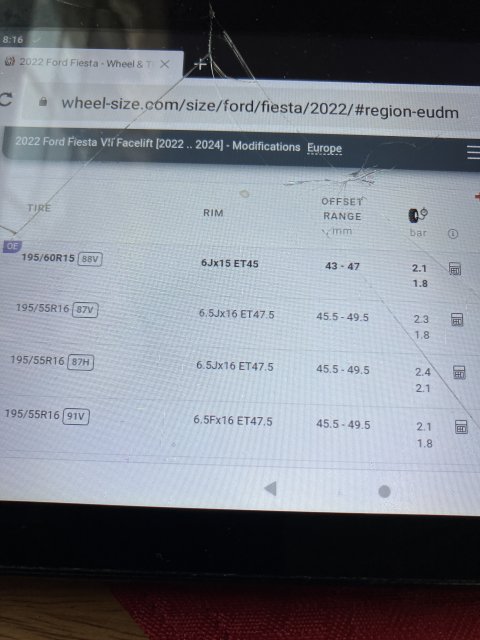

Hi Everybody, I've just joined to see if any of you clever people can answer a question I've not been able to solve. I want to buy a space saver 175/65/14 spare wheel, (the size listed on the door plate}, but when I find one on ebay the ads that show compatibility say it won't fit. The tyre is the correct size, and they can be on either a 5.5 J 14 with 47.5 or 37.5 offset. So what size do I need? Any help much appreciated.
From the spec chart, it suggests that the 125 is fitted with a 195/60R15 tire as base equipment. As long as you stay with the stated offset you should be fine with the smaller of the temporal wheels.

Thanks for your reply. The car was supplied new with 6.5 J 16 inch alloys and 195/55/R16 tyres fitted. I think that size spare would raise the boot floor (if it would go in). We live in a town, not rural, but having just wrecked a tyre in a huge water filled pothole (thanks Hertfordshire Council), I thought a spare would be a good idea. From your chart it looks like the offset should be 47.5, so now I should be able to get one.
