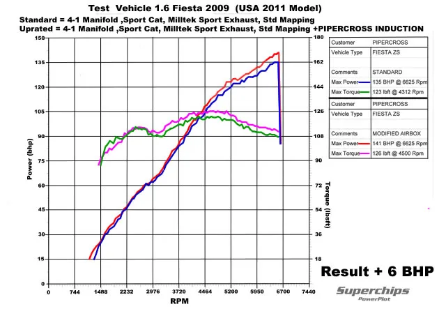

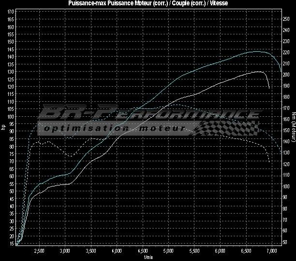

As yall can see both charts below these cars favor going past 6200K to make more power.
I contacted Superchips USA a while back and they said nothing was compatible for tuning at the time unlike their UK division (Bluefin) , then a few months ago I contacted BR performance to see about getting a file service , but their response was they only tune in house , they have 19 tuning shops including one Guadalupe Island and one in Guyana in South America but not a single one in the US.

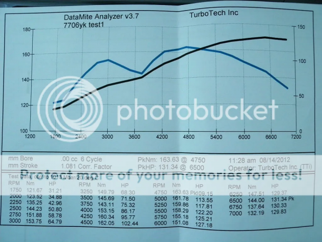

On the left is clear max power is at 6625 while on the right is around 6750kish (intake and exhaust system) , then there is that 3rd chart 131 whp 6500K or roughly 157ish Hp at crank, with this information is clear that 2011 have the same potential as the 2012+ years with the factory friendly PCM , there was another one sadly no chart where claims 125wHP(150ish crank) and 111 tq , which tells me he compromising torque in exchange for high rpm power ,but he is running an Apex i Neo piggyback with bolts ons ,matter fact it was Rick SES Fiesta from South America, im still looking as there is is more charts with different AFRs runing stock internals,once I get mine dyno hopefully soon, we can compare and maybe everyone on here can find useful comparison for their own fiestas according their mods :D

131.3 HP on wheel~
Mods:
Catcams camshaft
J1 Intake
Milltek exhaust system
Superchips Bluefin for std cams ,Rev limit 7000
