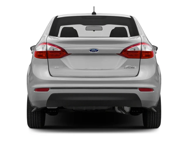

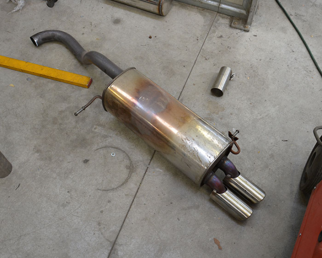

Would the ST exhaust fit a sedan? I suppose it would take a little surgery, but it might.
I think yes...with enough muscle, tubing, and welding you could make it work, but it's designed for the hatchback.
Ive read here and other that its almost a direct fit until the tail pipes since we dont have a cut out in the bumper

I would have a muffler shop add two longer tailpipes. You need to get the exhaust fumes out from under the tail of the car. There is the possibility of Co leaking into the trunk compartment and there is a whirling vortex of fumes, dust and heat from the engine back there that can be corrosive to the underbody and rear bumper crash bar.
