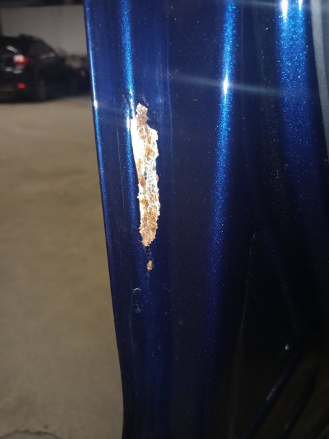

Well, that decision ended up burning me.
My 2016 Fiesta ST started showing evidence of rust creeping out of the door , hatch and hood panels at the seam edges. Fords warranty does not apply to corrosion in body seams.
So now i have a situation where a car that is not winter driven with rust bubbling out of the edges of body panels under the edge where the outer panel wraps over the panel frame.
Something was changed in the paint preparation process. My 2011 fiesta, also not winter driven, is absolutely spotless in this regard.
I probably should have popped for a good paraffin based treatment. Every closure panel on my 2016 is steadily rotting away at the seams. 20210216_173244.jpg
.i think i posted some in another section here a few months ago. I can dig them out and post em here too. It's very disturbing! When i look at that car now, i just get an image of myself removing the doors, hatch lid and hood and doing a complete refinishing job!
It will be the first time I had to do rust repairs and a repaint on a car i had not yet paid off!

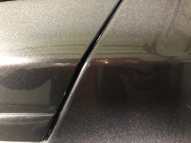

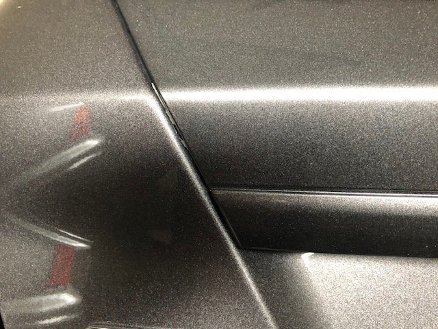

The paint on these cars is terrible. I'm not getting any rust yet, but the seams are not looking good. The lift handle is rubbing off paint.
