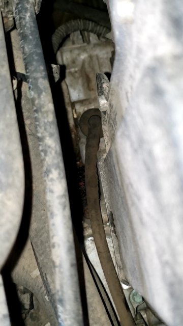

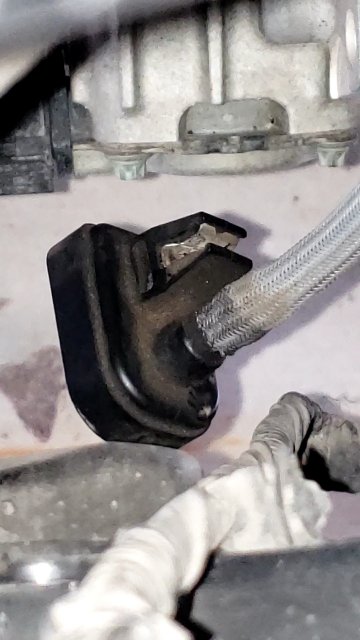

I have a random hose hanging that looks to have a ?sensor? at the end and is supposed to be attached somewhere but I'm unable to find the location. I'm a semi disabled Army veteran recovering from spinal fusion and a total knee replacement so I'm unable to get underneath to further inspect. Any insight would be amazing. Thank you. VideoCapture_20210722-181437.jpg VideoCapture_20210722-181517.jpg VideoCapture_20210722-181500.jpg

That is a "Breather tube" to allow the fumes that build up in the Transaxle and Transmissions - to vent so they don't "burst" a seal .

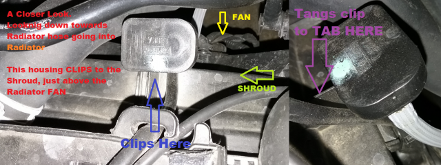

In your photo - the hose "clips" those two "tangs" fit on the front by the Radiator shroud on top - it's just a pressure relief vent to keep the seals from blowing out.

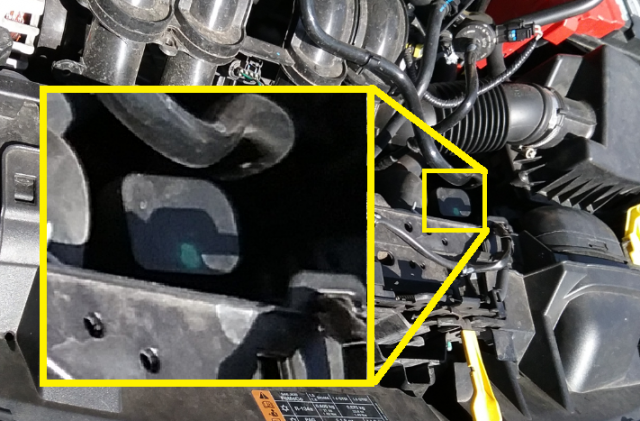

A Closer look
If the "tab" that this cover clips to, if you look closely at the photo you supplied in your post, you will see the metal "gator" that bites into that radiator shroud tang, if that clip broke - you can just use a simple Zip Tie to keep that vent up towards the top of the radiator shroud. Just don't pinch or kink the hose if you can avoid it.
This vent needs to be kept higher than the transaxle and transmission housings, else it will try to siphon out fluid that will fill the tube as the fumes and pressures expand the volume of the oil while driving - it will leave a puddle under the car - when that starts to cool down - it can pull it out by siphoning at the case.
