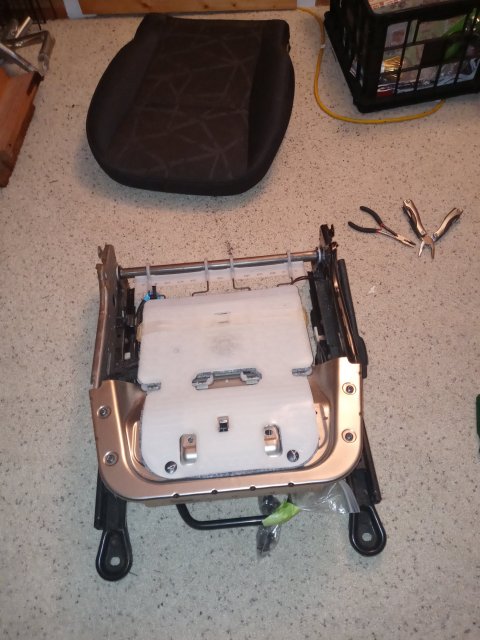

Just unbolt the seatback and remove the lower cushion and upholstery. Other than muting the side airbag with a resistor, just leave the weight sensor pad in place and connected. Then you will have a solid foundation for a mattress platform! 20211215_175359.jpg

Just unbolt the seatback and remove the lower cushion and upholstery. Other than muting the side airbag with a resistor, just leave the weight sensor pad in place and connected. Then you will have a solid foundation for a mattress platform! View attachment 6036
Yes, but i'd like to keep the use of the front passenger seat. that's why wondering about swapping to fold flat 3-door seat.
You would still need to numb the rh seat airbag sensor and the side impact airbag sensor. There is no free ride or work around on that one if you are looking to have a flat, solid surface to place a light mattress on along with a blanket or sleeping bag.
