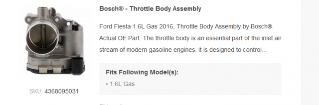

It wasn't the fuel pump...But there was a lot less noticeable hesitation and the car seemed to have more pepp after I replace it. I then replaced the throttle body assembly. Upon Inspection of the old one it was not only dirty but had some scratches and damage on the inside...Not sure how that could have happened..Strange how it would only act up at high speed and down hill. Seems to be fine now. The car runs like new again. Capture.PNG

IF you still have the OLD throttle body, remove/pry out the 4 - 5 clips that hold that black plastic board to the body - to expose the "guts" and look at the wiper arm follow it has - there are several "lines" of carbon trace that a set of fingers gently rub against to apply pressure and the electronics inside this "cover" are the means that the PCM uses to determine throttle angle - compared to accelerator pedal - and you'll also see the gearing and stepper motor that moves the main gear and thru the reduction process - moves a large bump the stepper does, to a smaller but much higher torqued - movement for the throttle plate.
Think of this like an older "Volume control" for a stereo - if the pot (variable resistor potentiometer) got dirty, you heard scratchy hissy sounds as you rotated that control - until it could find a clean spot and boom - the volume worked - but only at the spot of turn for the volume knob. Age and wear from typical use does this to any mechanical system.
As this unit ages, those traces of carbon get grooved and eventually they fail - because the whiskers used to contact the carbon, wear and the carbon trails get worn off to a bare plastic non-conductive bottom that now the system needs help in determining the angle it thinks it has, to the one that actually exists; that is part of the slop or gap in the electrical measurement that the accelerator pedal now has to take over and take its place as "presumed" angle to real angle.
So, in light of the problem you had - this condition and cause seems to make much better sense - the lean mixture it wanted - versus what the throttle could be "turned" to - prolly didn't match up very well so the system thinks there is a problem and set a whole bunch of flags and the check engine light.
Glad to know it was something simple - although not exactly cheap - but simple enough you can swap out the old and use the new and recover.

$70 part delivered ...Not bad ...Stuff wears out...And its The Bosch ...If you are not in California you can order the Dorman Version for about $50...Amazon wont deliver that part to California...
