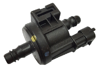

May be an EVAP issue - check that valve located by throttle body, make sure its connector is seated. It will "click-click-click" whine while the engine warms up to pull fumes and vapors from the tank.
Also check fuses too...
Not sure if your Fiesta will have a RESET switch for the Fuel pump but it seems the pump works, just the EVAP Purge line is acting like it's plugged.
IF you've overfilled the tank, the hose can get plugged, stalling out the motor.
May need to replace the EVAP filter system if you cant dry it out.

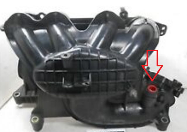

Wanted to show you ANOTHER valve that also pulls from that Gas tank - it actually is used by the ECM during Warm up.
This valve head to the Manifold, but uses a special type of twist on connector.
It's red in color.
IF that hose that runs to the Manifold is off, your Idle will be VERY rough even while warmed up.
That control valve is a lot like a "choke" on carbureted systems. It uses a pinhole valve diaphragm that uses a metered pulse length of time from the ECM to control the Idle Mixture while the engine starts and stabilizes - this valve "clicks" at a given rate until the engine can run lean enough without it and then operates in unison with the EVAP system as a bypass while the EVAP purge works, then closes off, it can also be used in high vacuum moments (shifts and similar actions) during deceleration to help with pressures and mixtures.
The only reason I'm mentioning it, is if you have a vacuum leak, this may be the area that causes the condition.,

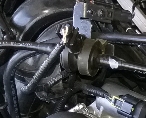

Do you think I could use hose clamps on the EVAP purge solenoid instead of the shrink wrap?
Answering my own question here,
If I were to use clamps I do believe the plastic would snap or crack due to the pressure of the clamp
