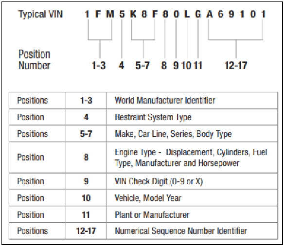

In some instances, there is enough "data" from the other sub-systems to force an unburned module (or a dumbed down one - erased the VIN) so that the VIN from the other systems can then be burned into it.
From that moment on - the system can then let the VIN code "instruct" the new module on how, and with what, will work - because the module itself being "programmed" thru its own VIN "code" - then lets the system "teach it" by developing a profile SPECIFC to that vehicle (Drive train and Engine codes are an example) so the system (that module) if similar enough can look inside its own program code (that EP- EAROM Electronically Programmable - Electronically Alterable - READ ONLY MEMORY) and know enough of how to shift itself - else it will not be able to know - and will need flashing - if the body and code types are not from the same class of vehicle - thru its VIN Code.
Look below - it's why the newer cars are such as mess...
And why places like Amazon and others that sell reman, are lousy at knowing how to get you the right part - because they don't look at the CLASS the device or module came from - just that their "What you wanted - so this is your problem" philosophy puts you in this condition instead.
