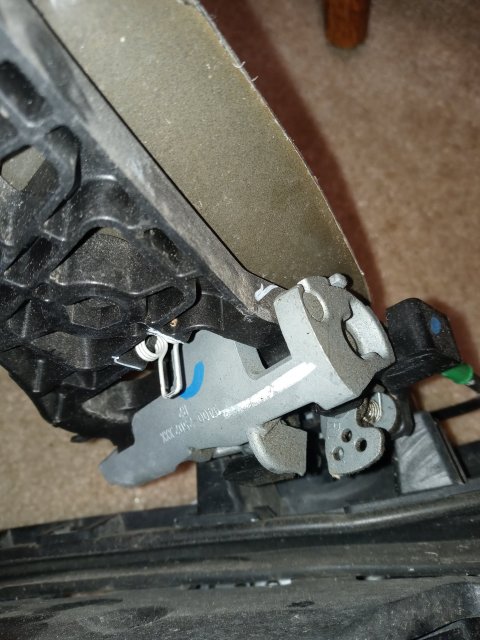

The images below are the passenger rear door handle assembly. It is predominantly plastic and coated metal. So i can only guess that the mechanism has failed but not due to rust. Maybe seized up due to no use?

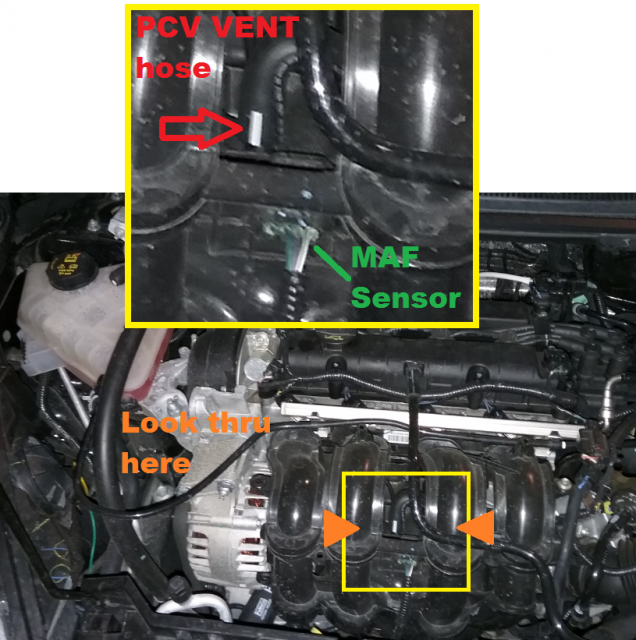

It's your PCV valve issue that gets me...you have a valve that mounts to a plate at the intake manifold that houses that valve. Works - like any other PCV valve - to take fumes from the crankcase (inside the engine) while you drive - and uses the intake manifold port - just by the MAP (MAF is towards throttle at the snorkel) which the hose should be on there - else if the hose or the valve is plugged - you might have some wrenching to do to get at the PCV valve - your line from the top of the motor to the Air intake is the breather line to suck in fresh air while the PCV valve recycles the oily fumes from the crankcase back into the intake - if the PCV valve or hose is plugged, there is no other place for these vapors to go except thru that breather tube - so if you're getting oil in it - get to the Auto store or dealer and get a new PCV valve or at least the rubber hose - the age of the vehicles the hose can crack open and suck air in instead of crankcase fumes.
You may also experience a smell from this going on - so if you do, ...
Best to investigate the hose, PCV valve behind it towards the engine
and that MAF sensor - if you have any idling or performance issues
this area can make your day...

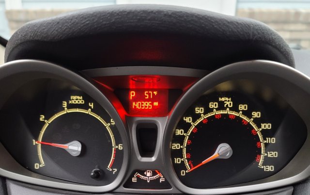

Ok attaching some pics. It seems I lied.. its 140k atm.
The door mechanism does click when using the electronic lock switch. When the handle is tugged, it moves halfway but no further, it's quite stiff.
