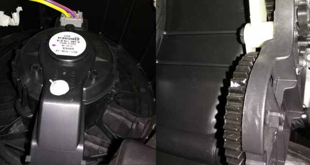

The Photo on the left is the Blower motor - in the housing - while the one on the right is simply panned the camera to show the gearing set = one big cog, moves the littler ones a set number of "teeth" to move the drum to open or close a port - which one of them can be seen on the left photo down and to the right of the round rotunda the motor rests in; the center of and behind this fascia is the squirrel cage the blower fan cage spins in to pressurize the vessel.
  • The Actuator your working with, is bolted to the three holes on the blower motor you can see the "holes" that hold it - with it's output gear drive meshing to the larger gear on the right photo.
