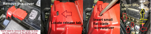

You will need to take apart that Red terminal and investigate the condition of that battery post and those fuses that are in that terminal - the wires BOLT to it, so it needs to be verified that the fuses here in this terminal - are still good and let power flow to the bolt that the wire bolts to.
Make sure the wires are firmly bolted - that Starter alternator big cable to the top of the terminal has a fuse in it too - 450 amps - make sure the cable is getting voltage all the time from the battery and those bolts are not loose.
