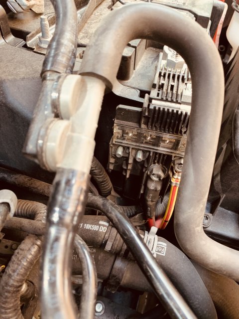

Need help ID of wire
The Fiesta pcm and instrument cluster is never really "off". Neither is the anti theft module. That module on the positive cable is a voltage limiter. Power is being fed to various circuits from the battery through the limiter.

Perfect! That’s what I was wondering, possible small draw overnight was just normal and batter couldn’t hold enough charge so I’ll get one tomorrow. It’s 5 years old so good chance it is that. Thanks guys for the help!
