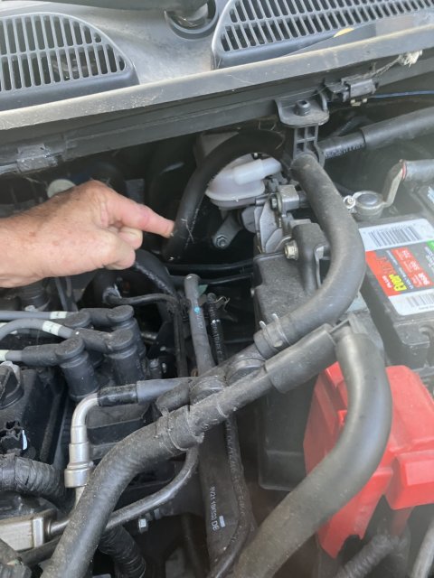

Pedal goes to the floor then goes solid - there is a brake booster and it's vacuum chamber which helps with the assist in applying the Power of the power Brakes - so the first or second push (pump action) of the pedal is a sign the vacuum in the booster is working and is sealing properly even when parked-

The thing uses an ABS system, which also adds lengths and volume of air or fluid you need to displace. So - to help with that, it may need to have the engine running - brake pedal and the rear brake lights off but PARKING BRAKE set - and bleed the brakes starting at the farthest point in length

The Brake Bleed procedure is pretty simple. You can even do it yourself if you have the tools. What you need; a vacuum pump, a hose to fit the bleeder screw nipple outlet, a container designed to work as a trap - (it may come with the vacuum pump so use that in those tools to help) and a simple open end wrench 8mm or so to fit the hex nut of that fitting and crack it open. You use the vacuum pump to suck out the fluid in the line and any air that might be trapped with it - into that container. The engine needs to be running to maintain the vacuum on the booster to help the Master Cylinder keep those drain back ports open so it can move fluid as you work the vacuum pump to bleed the system.
