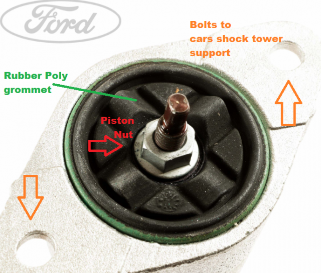

Pull back the felt in the back trunk and boot to find the shock tower upper mount...
Might want to check the bolts - it uses two on a metal cup to hold it to the car, while another nut holds the shock to the cup that bolts the shocks "piston rod" to the mount, the other two bolts then mount this assembly to the shock tower support
The reason this comes up is if the shock got damaged, the cup can crack and eventually fail - causing this rattle.
The Piston to nut also - that grommet can "push out" if the car got into some potholes and or rough road and heavily loaded. It can then rattle around and the upper rod can bang against the cars tower support.
You won't see any true effort unless you take the shock out and test it separately for looseness. For the piston itself tries to seat the whole affair when it's at rest - the noise can be from the extension hitting the cup or making the grommet rattle in the cup.

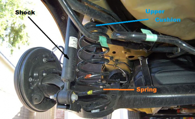

It’s also possible that the bushing pressed into the lower attachment eye of the damper has failed.
Given that the noise is isolated to the left rear corner and only occurs when the suspension compresses. That narrows down the point of origin. The only other thing that is possible is the bushing in the swing arm might be sloppy. But, it would cause some rear axle beam deflection that would give you a strange feeling in the ride immediately after the bump.

Turned out to be two things. The heatshield at the back was clunking, making me think the metal noise was also coming from the back. In fact, after securing the heatshield, it was a piece of the coil spring that had broken off at the front left, and was knocking around in the lower mount.
Bought a compression tool off Amazon, so I'm gonna attempt to replace the coil spring some time next week. Thinking of doing both sides to keep things balanced.
