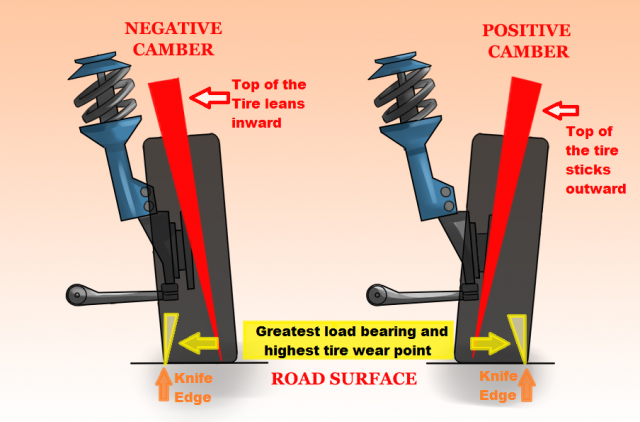

Adding Camber? Yikes!
Positive Camber - the top of the wheel sticks out the top of the wheelwell.(or bottom of the wheel appears to lean into the floor under the car)
Negative Camber - the top of the wheel (or tire) leans or tucks into the wheelwell, and the bottom of the tire seems to sag outwards - away from the car.
So this asks the next question.

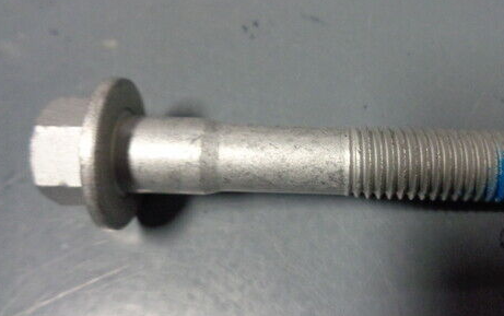

What size bolts are you using for the Strut - to - Knuckle?
If stock - they are M10 X 2 - if you use M8 X 2 (combination sizing) - then the lean you get is as much as 5 degrees - you want more?
The OEM Ford bolt uses a "shoulder" in which the Strut bolt seat and the hole opposite - are sized slightly different - the SHOULDER side of the bolt lets the head sit flush to the flange - while if you put it in the wrong direction - the shoulder is designed to prevent you from "seating" the bolt flush using hand pressure if you insert the bolt into the wrong hole per direction. Simply reverse it. That is...if you're using STOCK OEM (Motorcraft) spec struts. - the thread size lets the bolt in, but to seat it correctly and keep OEM alignment - the Bolts shoulder needs to seat with little effort so the shoulder spacing and the Struts own clearance to the bolt - are snug and so it keeps the OEM alignment degree setting.
When the outside of the tire is wearing - and they are on the front - that means you have a lot of positive camber and the knife edge is really on the shoulder of the tread and causes this wear pattern.

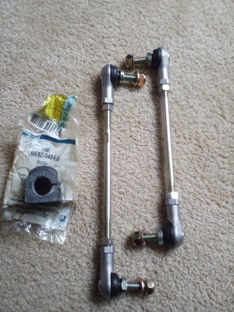

The big thing to make a noticeable impact is going to polyurethane sway bar bushings and adjustable end links.
Maybe Lions Tooth can weigh in on the camber bolt effects if he noticed a difference.
The stock frame bushes are a weak spot in the fiesta, made from a very spongy rubber compound that is not a "performance handling" item at all. Adjustable end links will allow you to really start putting the anti sway bar to work. You don't need to spend money on a thicker diameter bar. IMG_20231010_130358.jpg
