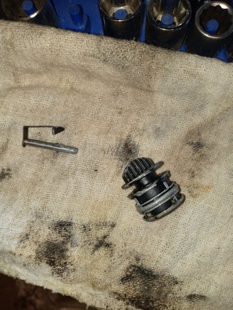

The image below is the plug and the retainer pin that goes in the side of the trans case to retain the plug. It easiest to see if you pull out the battery and the shield.

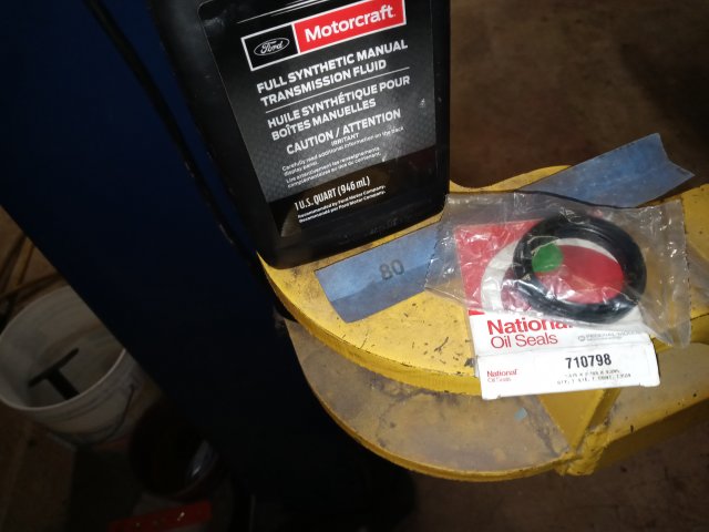

No filter or screen. I will post a couple more pictures in the morning. I had replaced the output shaft seals a little more than one month ago. But the new left side seal was also a leaker. So i am tearing back into that area again this weekend. The seals are cheap. But they are what retains the really expensive fluid in the case. Seeing even a small puddle of gear oil is the same thing as seeing money on the ground.
The image below is an output shaft seal. Costs about four bucks each. When these give up, you will be losing that synthetic gear oil. 20210131_152734.jpg

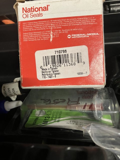

So I know this is a little old, but my Fiesta has been leaking out of the axle seal on the passenger side of the transaxle.... pretty sad for basically still new vehicle that has 13k miles on it now. Is the IB5 like the old Ford transaxles where the gears drop out if you don't support them with both axles out?
1,971
Hello MBP! No. You can just pop the output shaft with a puller or a narrow pry bar and a piece of wood at the fulcrum to distribute the force of prying. The seals are not expensive at all. Like, under five bucks each.
