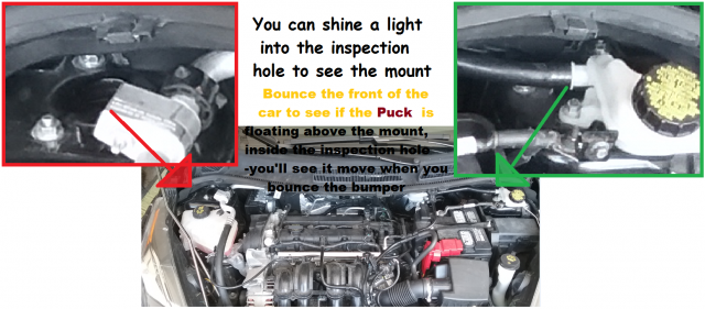

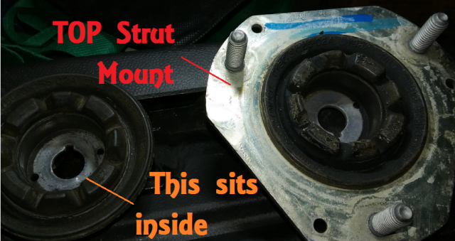

You have two, one on each side at the, and just above the, front wheels.
The metal base bolts to the car, the "puck" rests inside it and is mounted to the SHOCK
which is part of the "strut" the Strut is the spring, and shock, the spring pushes up and holds against the metal
thru a 2-piece plastic cup bearing.
The Stock absorbs road noise and mounts to this "puck"
Both are the strut, these two allow the wheel to turn (rotate to steer) but maintains the position as an axle.
The klunk you hear, may be from this assembly ...
the puck can pop out of the base and "float" until the weight of the wheel is lifted so the the puck can reseat.

I don't hear a clunk. Its not from the wheel area..at least it does not seem to be. And even on an absolutely smooth road, I hear it.
