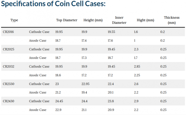

In mine they use 1 2032 - which is kinda' important due to several factors...
One - is their size...
But more important is their rated voltage at that size - for a given draw of current in mA
CR2032 can supply up to 200mA draw for a rated length of time RATED for 3 V
CR2025 can supply up to 165mA draw for a rated length of time RATED for 3 V
CR2016 can supply up to 90mA draw for a Rated length of time RATED for 3 V
