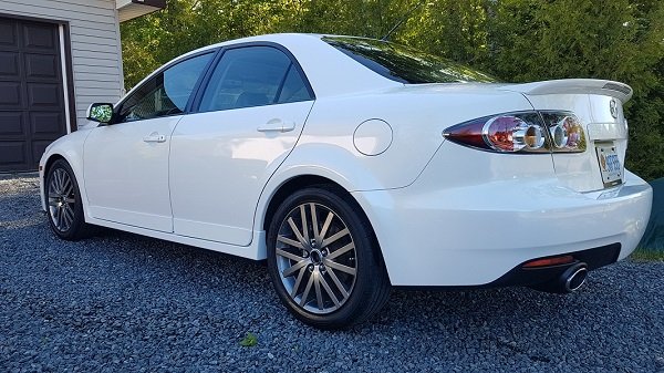

I was in the hunt for a deeper looking shine to my car. Because white cars generally don't reflect colours as well as darker cars, I was looking to maximize my gloss, but I didnt want to loose the long lasting protection. A few years back I had started applying Poorboys Nattys Paste Wax on top of my 845. That was how I was able to build a deep shine.

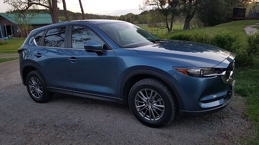

I picked up the 476s tin to try on my wife's CX5. It is said to last up to 12 months. Perfect, I can wax my wife's car a couple times a year. For less than $30, it was marginally more expensive. I was amazed initially at the shine, it took the thin flat looking Mazda paint and really bolstered the reflection. The colour grew in richness and the metallic texture gained a real 3D appearance. Great, so now I have a nice wax on my wife's car.
The next test was the longevity. So here are the parameters...In the winter here the temps run from -18*C/0*F to -30*C/-22*F over a 3-4 month period with occasional breaks. Some weeks wont get much above -25*C/-13*F. Needless to say, with living 20 min from the city, the highways are regularly salted or sanded. The car parks outside all year. I went to the coin-op and rinsed the car off (no soap) a handful of times over the season. The car was coated in 476s in mid-October 2020 and the first hand wash was completed in early-May 2021. And 6 1/2 months later, with no care...The wax is still working, water beads right off. There has been a small amount of hydrophobic and contact angle degradation, but for being ignored, this stuff has accepted the challenge and overcome just as a strong coating should.
I was able to compare in my minds eye the 845 vs the 476s on my wife's car, so this year I decided to apply 476s to my car. I don't need the long lasting protection, my car is parked in a garage, never sees snow and only gets used for cruising and parks in a relatively private lot at my work. I wanted to see if the shine would help my car pop a bit more, possibly with less coats too.

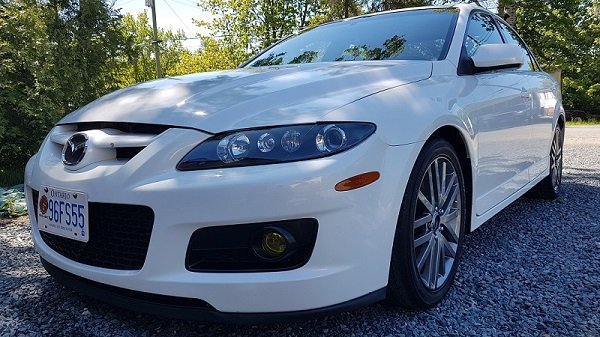

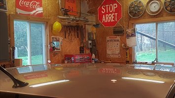

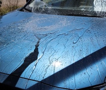

Compared to the 845/Natty's combo, I think the shine and depth indoors is there. And as you can see in the driver side doors , there is colour definition and clarity outdoors too...even on a pearl white car. In this picture, it has been a week since application and one wash.
And below the glossy shine, giving the car a slick look. Almost makes you want to touch it just to feel how smooth it is.
White paint is very forgiving when it comes to blemishes and under paint defects, but in the end is very hard to get it to pop like a darker colour car. Add to that the pearl, and often the cool halo that the pearl gives off will interfere with the clarity and gloss. The wax work I put into the car diminishes the pearl during the bright day sun, but in the evening when the sun angle is low, the pearl comes out ten fold. If anyone is looking for wax suggestions or researching a new product, I would suggest you look into one of these two. 845 for the ease of use, 476s for the lasting finish...You will not be disappointed!

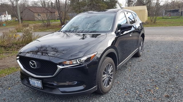

If you are looking for examples of Collinite 476s on black...

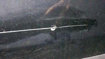

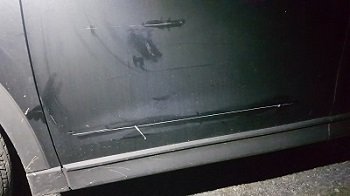

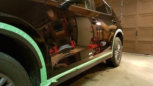

The owner of this car wanted a protective coating on her car and recently had an incident with shopping cart rash. Its a culture in my town to be a lazy degenerate and leave loose carts about the parking lot, but I digress. The shopping cart cut 2 scratches, the upper being about 12" horizontally, half way up under the mirror. The largest rash located a few inches above the bottom trim, runs the full length of the door.
After a little bit of compound work and wax, the damage is much less of an eye sore and will protect the area until the owner is able to have a body shop repair and respray the door.

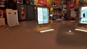

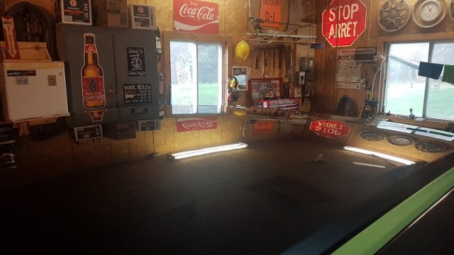

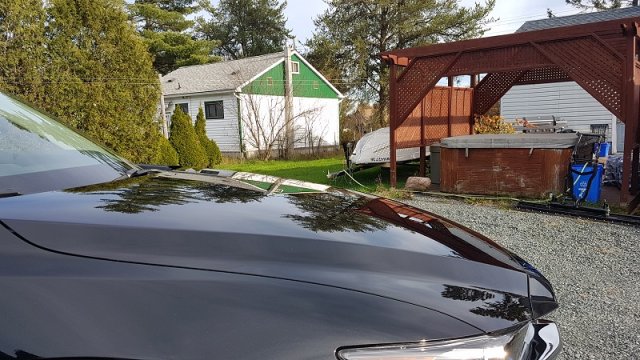

When waxing I also like to perform a little swirl and scratch maintenance on the hood of a car. The hood is one of the largest flat panels and usually the center piece when walking around a car. Because of the size and it is situated horizontal flaws are easily noticed. Cleaning up any damage in the top layer of the paint from bugs is easily erased as well. The car came with a considerable compliment of bug remnants as the owner travels largely highway for 45 min to and from work daily.

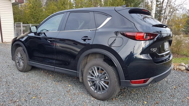

The colour reflection in the hood is fantastic and the depth of the black paint is greatly enhanced. Much improvement as seen in the following video...(polished clean paint on left, Collinite 476s on the right)
The colour is Mazda Jet Black. The metallic also comes alive once its been topped with a nice clear candy coating...
Although the thought of me owning a black car is the source of many nightmares, after this job I entertained the thought of having one. The wax did a phenomenal job at bringing out a luxurious richness in an otherwise utility robot applied thin paint.

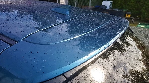

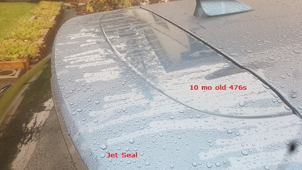

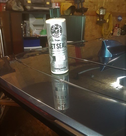

I applied Jet seal to the rear roof extension on my wifes CX5 as a test area. Before I applied the sealant I had buffed the area clean with a mild compound and light polishing pad as I was already remediating some other blemishes on the car. The surface was as clean as possible leaving a fresh canvas for the sealant to bond to. I applied Jet Seal to the right side mirror cap and headlight lens while applying a coating of Collinite 845 to the left mirror cap and headlight lens.
The product applied decently with a microfiber pad as per instructions. It was easy to get the product evenly and thinly spread across the whole panel.
Initial impressions favour the slickness department. I had to place the bottle on the panel immediately in front of the test panel because the bottle wanted to slide off. Clarity in the reflection was decent, however the reflection in the 10 month old Collinite 476s was equal.

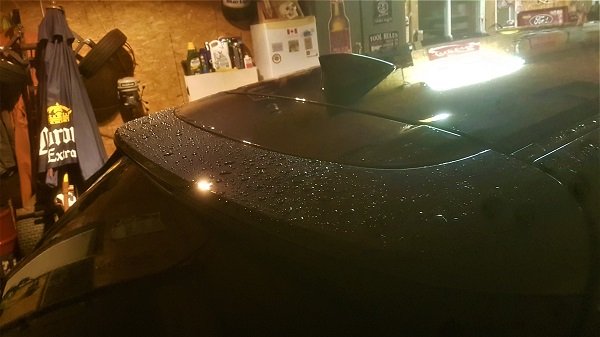

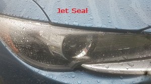

Fifteen days had passed since the panels had been coated and I was interested to see how the coatings had stood up.
The morning had the residual of last nights rain on the car. Although the whole car had beading, I opened the rear hatch to see how well the water would shed from the surfaces while vertical. To me it appears the old 476s is still exhibiting more hydrophobic properties than the 2 week old Jet Seal.

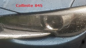

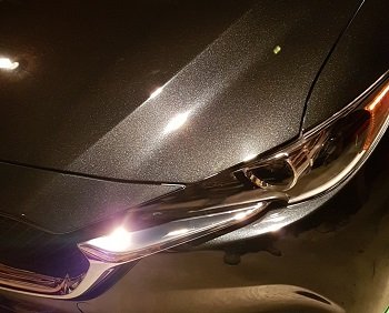

As for the headlight lenses, there is little difference. The mirrors also showed no particular advantage from one side to the other. Tomorrow I will wash the car giving me the ability to get up close with the surfaces.
At this point it will be my recommendation to bypass CG Jet Seal. I do like CG, products are easy to access, good value for dollar and good results can be had by even beginners. Its been 20 days since I applied Jet Seal. Most notably I would expect the product to have more hydrophobic abilities. I dont see big beautiful beads of water on the panels I applied. Of the water on the panel, the beads seem flat and the low contact angle dosent cause the water to stand up.
Reflective clarity is ok, I just wish there was more. The clarity isnt better than the old wax applied to the rest of the car(look at the roof panel...10 mos. old). A true wax will also have a deeper tone, or a richer look adding visual depth to the colour. This is something I think a sealant struggles with.
The mirrors appeared to act as if I hadn't applied. The insect strikes required the use of my bug sponge, I regularly only use my wash mitt when my regular wax is providing protection. At only 20 days I expect a product to still provide less effort when cleaning.
In the end all this adds up to what you get for what you paid. With these test panels and a bill for $50, the CG Jet Seal isnt a product I will add to my arsenal. Compared to my goto, Collinite 476s, it sells for about $30 and does provide protection for almost a year so far.
