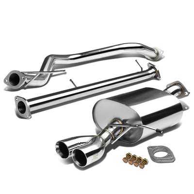

The J2 is a nice looking system. I like the flanged connections and stainless steel construction.
The $350 to $400 price is not outrageous. I think that this system is much more likely to be found on an ST than a basic fiesta. J2-CBE-OS-063-1_400x400.jpg

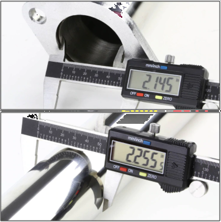

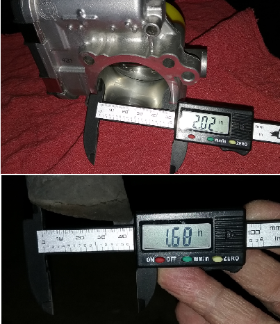

On the Left - the SITES Exhaust pipe size, on the right for comparison is a STOCK Fiesta SE both Throttle body bore diameter and the exhaust pipe single outlet diameter in inches and tenths.
The outlet of the standard stock Fiesta is about 25% smaller or restricted by that amount - at the muffler. This number is arrived to by comparing the bore size of the throttle body, in comparison to the outlet bore diameter at the tail pipe.
This is also not taking in any consideration from the construction offering any sort of restriction. This is just a poor mans' best guess; as sizing of the inlet and outlet pipes show where they placed emphasis on emission versus performance.
Why does this come up? Well performance and economy can't be made to meet in the same room in some instances.
So, trusting that the muffler you got, by itself, has no reducer or any sort or restriction - should do you well for performance - but fuel economy might not be the best. Not that it matters much.
