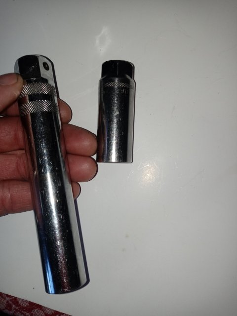

I never use a regular 5/8 spark plug socket on plugs in twin cam engines. There is a extended length version of socket for getting the plugs out/in without breaking the insulators. It's worth every penny of it's slightly greater cost. Especially since double platinum or iridium plugs are so expensive.

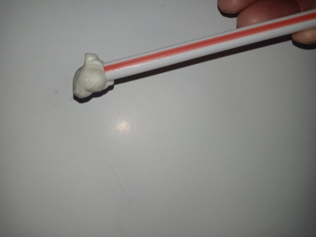

In the rare occasions I find bits of insulator in the plug galleys of twin cam engines, i take a McDonald's drink straw and a bit of freshly chewed bubblegum to dive in and grab the chunks. 20220702_083002.jpg 20220702_082540.jpg
