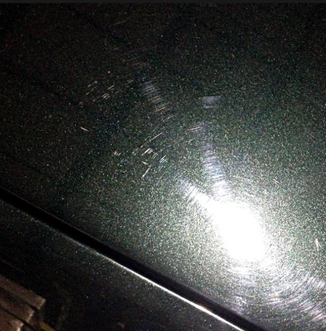

First of all, let’s talk about what we are trying to prevent here, swirls. I am surprised all the time when people tell me they thought swirls in their paint were normal and that there was nothing that could be done to get rid of them. This could not be further from the truth. Here is an example of what a badly swirled vehicle looks like.
The circular marks in this paint are swirls. They look like they are round, but in reality there are thousands of tiny scratches in every direction that make it look round. Swirls like this are caused from a few things. The most common is taking a vehicle through a tunnel car wash that uses brushes or fabric to clean the exterior. They are just too stiff and not kept clean enough to be used on paint without causing swirls and other marring on the paint. Sure they will get your car clean, but at what price? The other cause is by using improper products to wash and dry a vehicle. You just can’t grab a bath towel from your bathroom to dry your car after you wash it. It is far too stiff to be used safely on the paint. You also can’t use the sponge in your sink to wash the paint. It may be soft enough, but it doesn’t have enough areas to pull dirt away from the paint. Since it can’t pull the dirt away from the paint, all you are doing is rubbing the dirt into your paint, which again, if causing swirls.

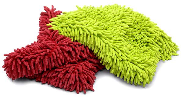

Next we will address that wash media, or what your will use to wash the vehicle. There are tons of different products out there from natural sea sponges to giant brushes, and a lot of them work very well. The main thing to look for is a product that has plenty of area to pull dirt away from the paint. For this reason I prefer using microfiber mitts or pads. These have hundreds of microfiber fingers that can pull dirt away from the paint. They are also easy to wash and can be used quite a few times before needing to be replaced.
The most important thing to remember is to clean your wash media after each use so you know it’s perfectly free of dirt and debris before your next wash. Also if you ever drop your mitt on the ground be 100% sure that you rinse it out before you touch the paint with it again. The last thing you want to do is get a small pebble in your mitt and then start rubbing it all over your car. It may take a little more time, but it is certainly worth the extra effort to keep your paint swirls free.

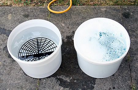

First you want to fill both buckets with about 3 gallons of water, and then insert a grit guard at the bottom of each one. You can now add your soap to your wash bucket. It’s a good idea to mark your buckets “wash” and “rinse” if they are identical so you don’t get confused as you are washing. There are some buckets out there that are already marked if you want to get them, but usually they are marked up quite a bit just for having a sticker applied. After you add your soap be sure to mix it into the water, you can do this easily by spraying a few powerful jets of water from your hose into the bucket. At this point go ahead and put your wash media into your soapy bucket to let it soak and get soft.

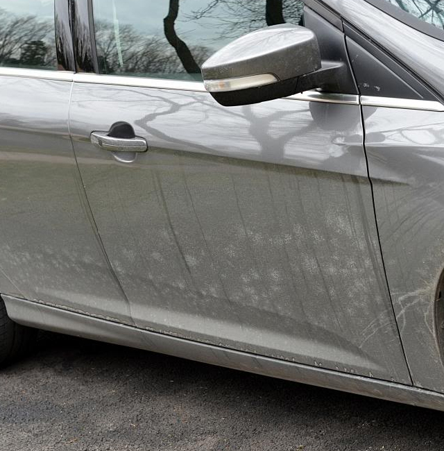

Now that you have your buckets filled up, you want to pre rinse your vehicle. Use the jet setting on your hose and just rinse the vehicle as best you can. By removing as much loose dirt and debris as possible, you are cutting down your chances of marring the paint dramatically. This step will only take a couple minutes, and can save you from extra work during the wash.This is the kind of stuff that you want to pre-rinse off as much as possible.
