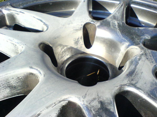

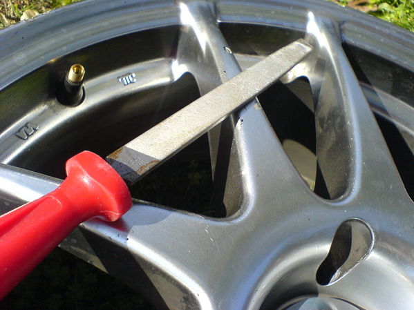

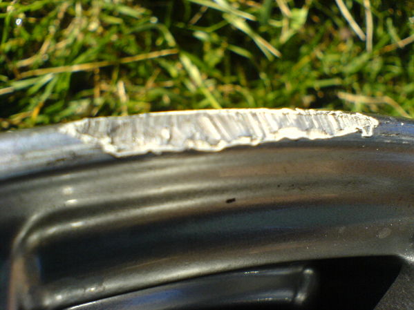

Basically, we will begin by using a metal file. go along the rim, in one direction, going up and down, until you remove protruding, sharp edges from the curb-rash.
now, you can go across the face of the gouge, or curbage damage... leaving with you surface that looks like this.

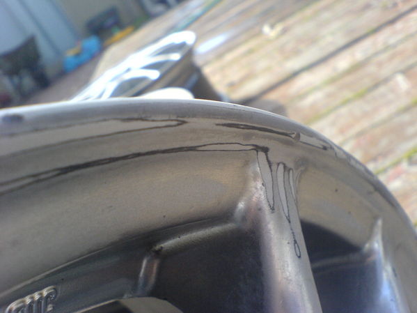

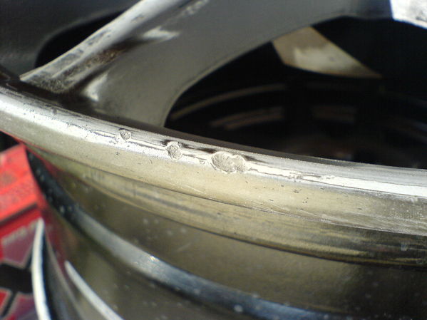

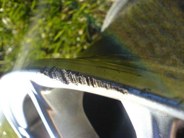

Now, put on your gloves, and wipe some JB-weld on there. I used an expired card I had laying around. Get a little glob of JB-weld on an edge, and swipe the card against the bead of the rim, where there is curbage.
Apply enough to fill in the damaged area, and a little more-some, so you can finger wipe it across. You should have bought a box of gloves, because yes, you will go through them like crazy.

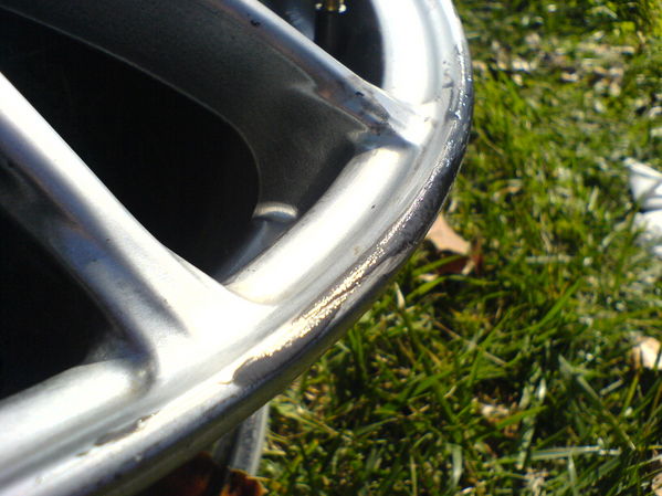

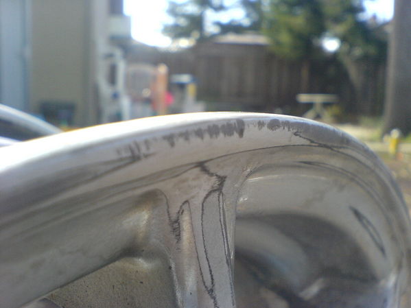

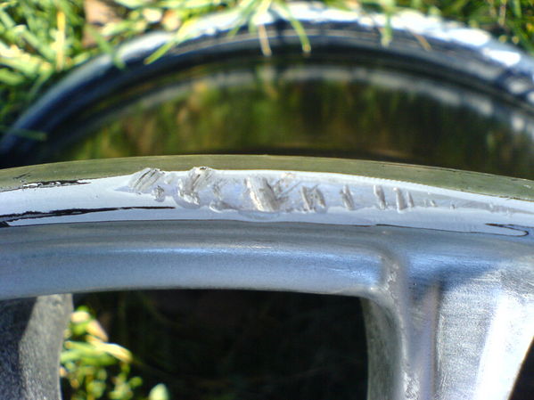

In 4-8 hours, you should be able to sand off the JB-weld. I didn't chance it, and I waited until the following morning.
Sand the rim smooth, and add more JB-weld if necessary.

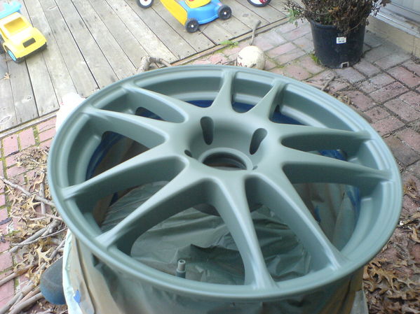

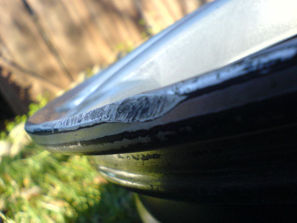

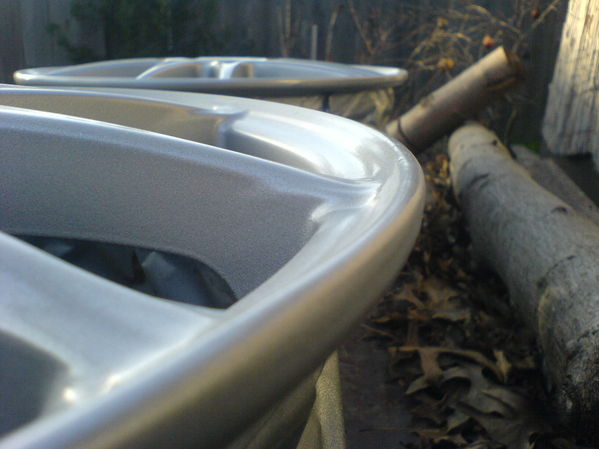

Apply 2 thin coats of Etching primer. Wait 5-10 minutes. Spray your paint. 3-4 coats usually does the trick.
Let rims cure for a few days, before mounting and balancing tires.
Hold off on cleaning your rims for as long as you can. NO chemicals, solvents, or cleaners should touch the rim for the first 30-45 days.
If you need to clean your rims, use only Water, and a clean microfiber towel.

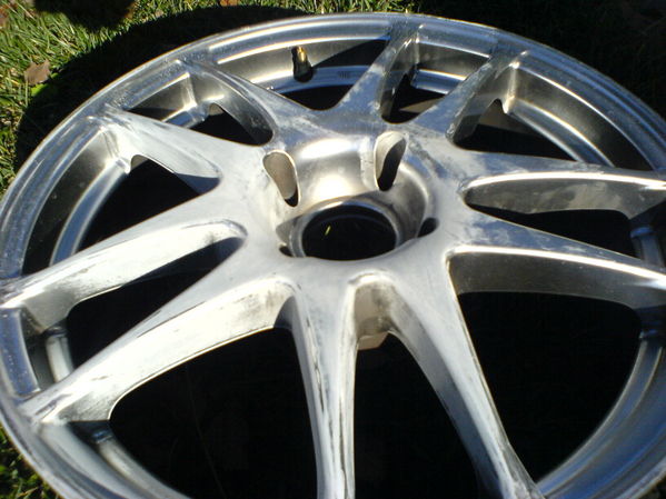

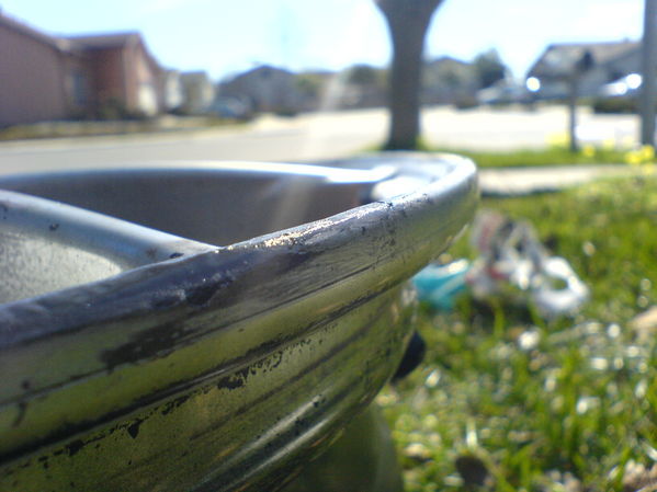

Before:
Just getting started:
Applying JB-Weld:
Sanded JB-weld:

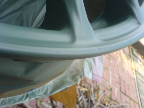

Applying Etching-Primer: (2 thin coats)

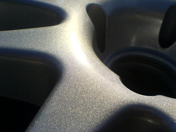

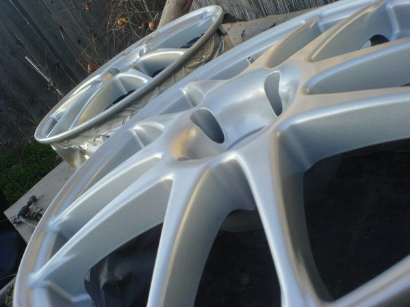

Painted, and Done-Dealio: (4 coats of Duplicolor Silver wheel paint)
