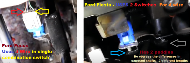

They are mechanical and use physical plunger stems hooked up to springs that help keep tension on the plunger so it can operate a set of contacts to show some type of action is occurring at the pedal. Same with your Brakes - if these plungers are stuck - worn or otherwise questionable - they may not send the right signals properly to clear a condition.
For the Brake - you have two - a Blue / White and Solid Black - one controls the Brake Light, the other controls "Cruise Control".
As a redundant system, the Brake Light Switch is the eventual override and has final say - so you know - the Brake lights have to be on to help the system CLEAR a condition.
The Cruise Control switch, also helps with Brake to offer "Hill Assist" - but does not have Final Say. If it is damaged though - the Brake Light is the only thing left in the deck of cards in which is has to play and have any chances of a winning bet. So if both switches are adjusted properly - the Hill Assist condition never occurs UNLESS IT IS SET, because both switches are sending Signals to keep specific conditions "cleared".
IF the shafts are dirty or coated with something - this can cause a "slow release" worse than an Aspirin, at least the timing part of it. You don't feel well in pain, so you take it and 24 hours later you're back to work - only now does the pain seem to subside after you suffered thru it. Ok, maybe not that much drama - well, you get the idea - might want to investigate their throw - from release to full extension - make sure the plungers are seemingly wanting willing and able to be working and not sticking in one position or even if they are even there - some switches can fall out of their seats and dangle - which can cause issues when you didn't think they could because you noticed a quirk but the condition seems to have cleared itself - until now...

For if you own an automatic transmission not the Dual Clutch "Sport" type - the two switches on the Brake pedal - if they are not properly adjusted - will put your Fiesta into what feels to be a stumbling mode.
There are two switches - one Black - for Brake (and is also Override) and a White or Blue color switch - which is used for Cruise, as well as a "non DCTS" a type of torque converter clutch engage.

Basically:​
  • One pair of wires are used for Transmission - the other set is for Brake light and BCM.
    • Manual uses the two - one for Brake light the other for "Idle up" take-off
    • Automatics use the two - One from Brake Light - the other for Transmission Solenoid engagement control
  • Ford Focus - uses this as a COMBINATION switch - one housing - two separate contacts same results
  • Ford Fiesta - two separate switches with PADDLES that can be adjusted to set ASPECT of which engages first to help in control.
    • Aspect being - one Control switch can be tweaked to act AFTER or BEFORE the other one to alter the way the system handles braking and transmission control during braking.
    • Setting both to engage at different positions of the Brake pedal application - changes the way the PCM/TCM processes the braking action.
    • These also are putting (pushing using spring pressure) on the Brake Pedal Pushrod
      • - setting the paddles too close will force the brakes to drag or engage while the switches are not set properly to release the system to handle braking
      • - you want to set the paddles to engage the brake light but also set the transmission control to disengage - or release power to prevent overpowering the brakes when you're attempting to stop and possibly stalling the motor as well as extra wear on the transmission you don't want.
IF the switches are not set up so they are close together but not EXACTLY in sync, they work better by letting the White switch lead first into the press to stop moment - then the black one lights the Brake light.
It is this action - which is monitored by the BCM, can then anticipate deceleration, acceleration or coast better if they are close to aspect but white leads to black on press. Release: Black leads white. This is done so; the solenoid and the rest of the transmission drive train are NOT placed in "jerky" modes while you're in stop start traffic or waiting for a light to change - then, when you release the brakes, it begins the engagement without too much creep or launch.
You can feel the "step" engagement if the White and Black switches as well as Brake pushrod to applied brakes are too far apart, you can feel the system drag itself and you can be left literally sitting there because of this incorrectly set aspect. If the switches are not set right - the brake light switch takes control, and you could be sitting there until the light goes off and that action then clears the BCM and standard Automatic Solenoid to open and begin the upshift process. On top of that - the drag in the brake release affects how the system even knows what gear to be in - without the stumble.
