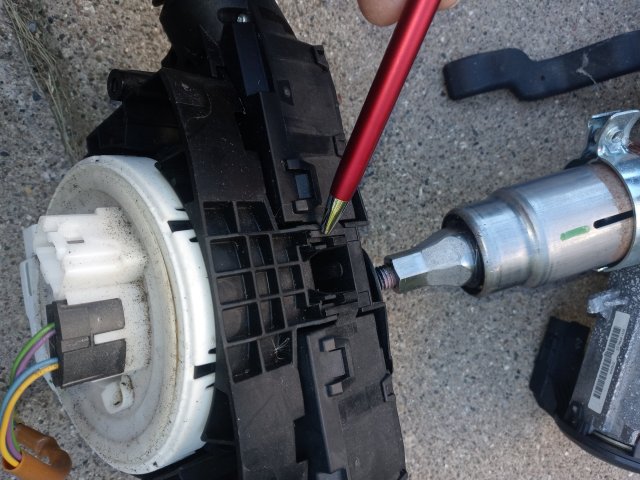

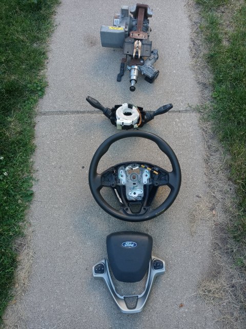

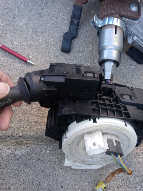

Its not too involved. You need a couple screwdrivers or a multi bit set. It is nestled against the turn indicator switch with a couple of screws. The white plastic thing in front of the switches is the airbag clock spring. You don't need to take the steering column apart to take out the wiper control switch, these images are all i have on my phone of that area.

Unless you like reading engineering exploded drawings - it explains it nicely - layer by layer of that "onion".
