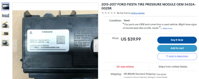

Ok, thanks for the reply. My question is, where is the receiver in the car. Is it the module or the BCM, both or something different? The part number for the receiver module that I find is shown here in this link.
some say it's behind the left wheel. it isnt
some say it's under the center console, it isn't
I know where the BCM is.
I have already finished checking the sensors and determined it is in the car.
https://www.ebay.com/itm/1845534440...F1vQ7YKbCoZA9JkjO6Ciz8DK3EDGDYCsaAj1BEALw_wcB

I understand that the tpms reciever is integrated with the BCM on the north American version of fiesta.

Thanks for the reply, I have heard that version as well yes.
Presuming that is true, what is this part shown for? no one, not even Ford seems to be able to tell me? lol
