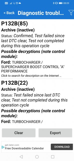

I have error code P132B AND P132B(22). What does the p132b(22) mean, as my scanner will only tell me the code and not a description.

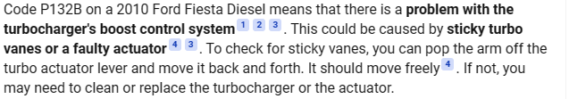

This thread deals with a Diesel Turbo model of 2010 - since we have little information to work with, the engine - if its turbo'd - is the only way you'd get this code. It may apply to your situation.
It deals with an actuator and the bushing used to work the valve on the turbo. If this bushing is worn or gone, you'd also hear some form of a clank or noise from that missing bushing or it's Bunge - so review the thread see if it helps you.

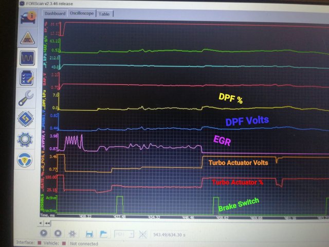

I have replaced the boost control solenoid twice (as the first one was apparently a cheap fake and the engine management system didn't like it), the vacuum actuator and position sensor assembly, and I have also replaced the vacuum pump as I noticed a very rough vacuum causing vibration when braking (due to the brake booster I presume). All this along with the cut vacuum pipes was leading me to assume it is a vacuum line issue. I tried monitoring it with ForScan and it seems to abruptly lose sensor input from both the turbo and EGR valve at the same moment, but I think that is more leaning towards an electrical fault than a vacuum fault.

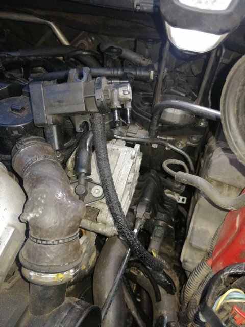

Attached are photos of the old vacuum solenoid which I have since replaced with a new brown body type which I am assuming is more correct for the car. The black one was used on Citroens and Peugeots, which are basically the same so I don't fully know why it would make any difference, and it doesn't seem to have. I am not 100 percent sure I have all the pipes in the correct order though...
You have a potential leak in your turbo plumbing or faulty boost control solenoid or possibly a bad ground connection of same or something as simple as an exhaust system leak. It is not a exactly specific mil. More like points in the general area of the issue. Check your ground connections. Inspect your pipes and clear the mil and test drive.
Yes. It's pointing at the boost control. The computer itself may be faulty, but it's more likely that it's not getting correct readings to work effectively. Given what you've described, I'd start with scotman's suggestions.

Thanks Econoboxrocks and Scotsman. Just wanted to update you all. After trying to check the previously butchered vacuum lines using a hand vacuum pump, I accidently broke off one of the ports on the second Boost Control Solenoid. The vacuum check passed, so I resigned myself to a third solenoid... However, since changing it a month ago now we have not had any recurance of the engine warning light. So that seems to be it. For reference, the one the car came to me with was the black variety from a Citroen C4, which may explain why yhe pipes had been modified. The first replacement I bought was immediately refused by the ECU, and the second one worked OK but we would occasionally get the P132B code on cold starts or when the DPF tried to burn off. Still waiting for a confirmed DPF burn off, but it's been driven as normal for the last month with no issue.
