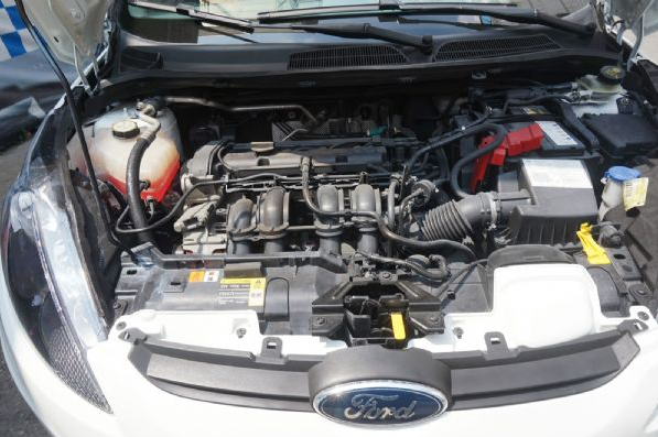

  • See that "orange color" container in the upper left?
    • That is your coolant reservoir.
    • It uses a cap and if the coolant is discolored or low,
    • it could be that the tank is failed, it can't hold pressure, or has oil mixing in from a bad/failed head gasket.
  • Also possibly means your Water pump is going out - or hoses or radiator is leaking
So your system overheats because the coolant is low, or has no pressure or circulation to help with cooling.

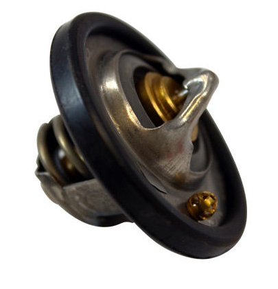

Ok, seems to point back to a bad thermostat.
The Heater "Works really good" when it "overheats" so that tells me the "slow response" from previous may mean the thermostat is not working very well anymore.
It would stick open letting some coolant leak thru, now it's not regulating even on that - so it or the water pump? You say - you have heat so that rules out the water pump (for now)

Cheaper than another engine.
Runs less than $20 USD - add in shipping...
RT - 1211 190F - 87C
