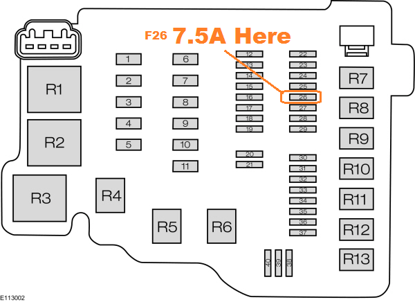

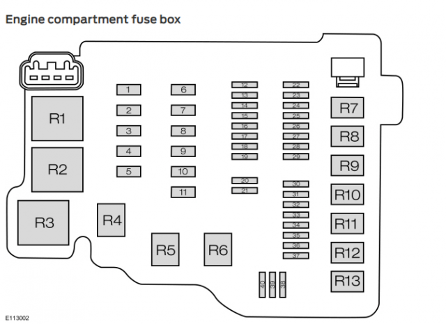

Locate your Engine Compartment Fuse Box...
Not a big deal when the windows are up and it's winter - but rain and snow take their tolls - now it's summer coming on and you have to use the windows - the 2010 year until now - being 13 years. Something's gotta' give.
Then if that fuse is still good...
Then locate your secondary one - (Fuse Box)
Passenger compartment behind Glove box.
Locate F26 - 30A

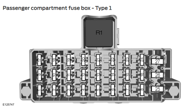

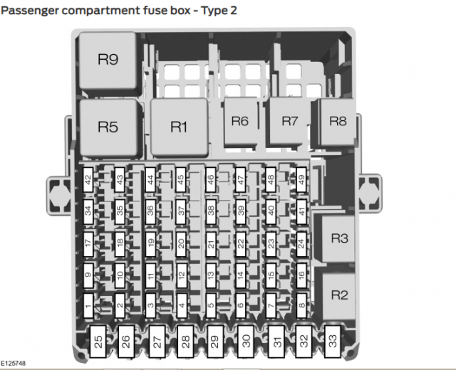

OR if you have this design behind the Glove Box.
It's F25 and R2 and R3 relays inclusive.​
