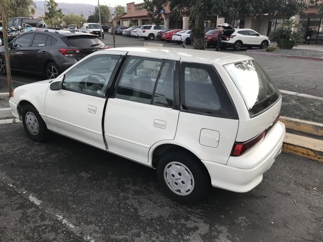

Gas mileage nut here. I currently am the proud owner of a 1994 Geo Metro, 3 cyl. 5 spd, 4 door wagon (I know, I know). I love as mileage. My wife doesn't like driving it, It does have rough idle issues etc. But it does go from point A to point B sipping gas. I never realized the Fiesta came with a 3 cyl. Turbo. The gas mileage is close to the Metro with air bags, some noise reduction etc. and a turbo! I very well could be looking at purchasing one of these swell cars (as my wife might actually enjoy driving it). What should I look for in finding one? Does high mileage affect them? My Metro has 227K currently. What are it's downfalls? Thanks.
