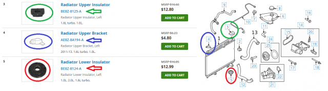

Hello I have a 2013 Sedan Ford Fiesta and the evapcore of my radiator
59
14
Rapid City
SD
2013 SE Ford Fiest 4 door Hatchback
Has lost it's black rubber bushing and thus it now makes a noise when I hit about 50 to 60 mph all I need is the rubber bushing to put back on it and it is normal and working again can someone help me find this online
The nearest Ford dealership parts department can sell you a replacement. You might want to buy a pair of them because the other one is doing all the work now and it might be weakened. I would guess that they might cost about $7 or so.
1,679
1,263
Your Results may vary, - we don't know which "cushion" is affected - you have two "pairs" for just the Radiator.
For AC? We'll need more info - just the condensor rests in a cradle - in front of the radiator.
